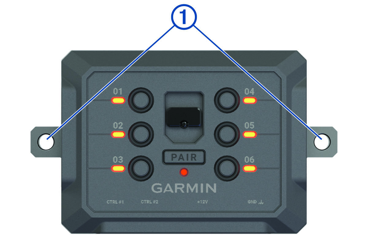

  1. Place the mount on the selected location.
    Device mounting locations with a callout
  2. Using the mount as a template, mark the two screw locations Callout number 1.
  3. Drill pilot holes (optional).
    For some types of mounting material, drilling pilot holes is necessary. Do not drill through the mount.
  4. Securely fasten the mount to the surface using the appropriate hardware for your mounting surface.
