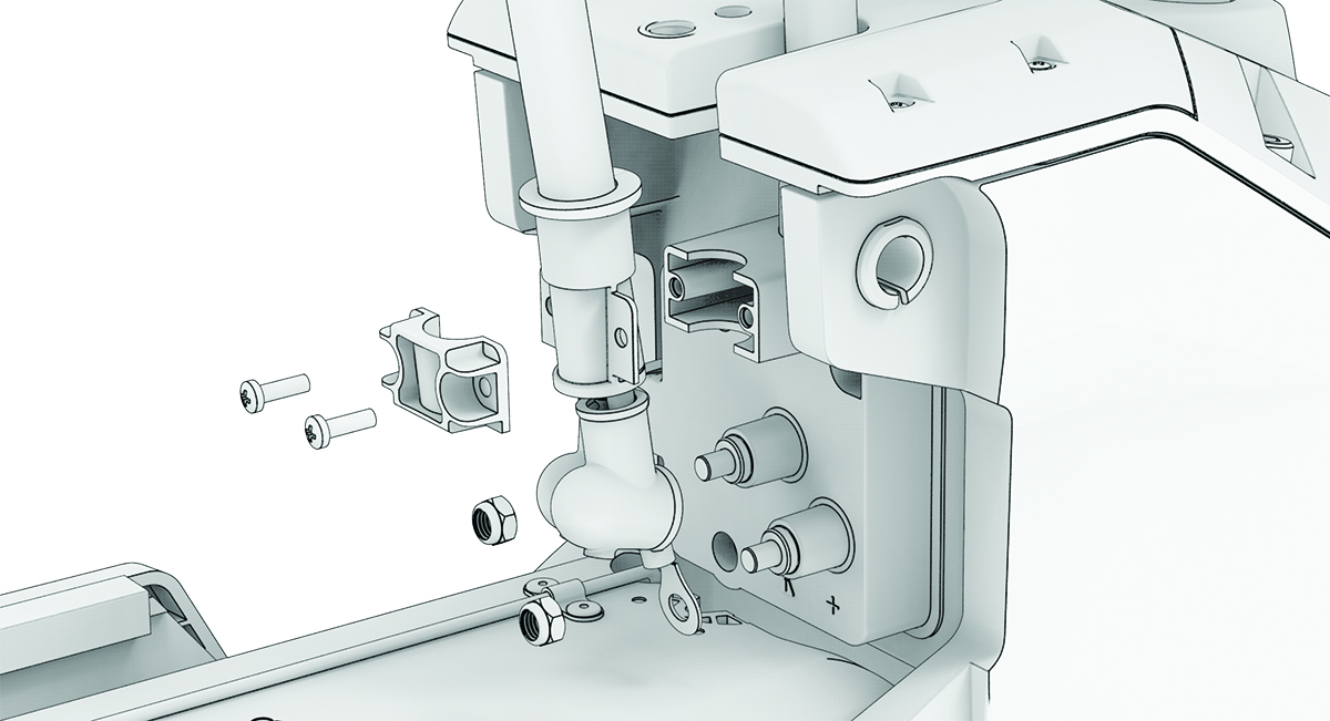

  1. Disconnect the upper link of the mount from the steering system (Disconnecting the Upper Link from the Steering System ).
  2. Pivot the upper link away from the steering system.
  3. Using a #2 Phillips screwdriver, remove the bracket that secures the power cable to the steering system.
    Power cable terminals
  4. Pull the rubber shields away from the power cable terminals.
  5. Using a 10 mm socket, remove the nuts that secure the power cable terminals.
