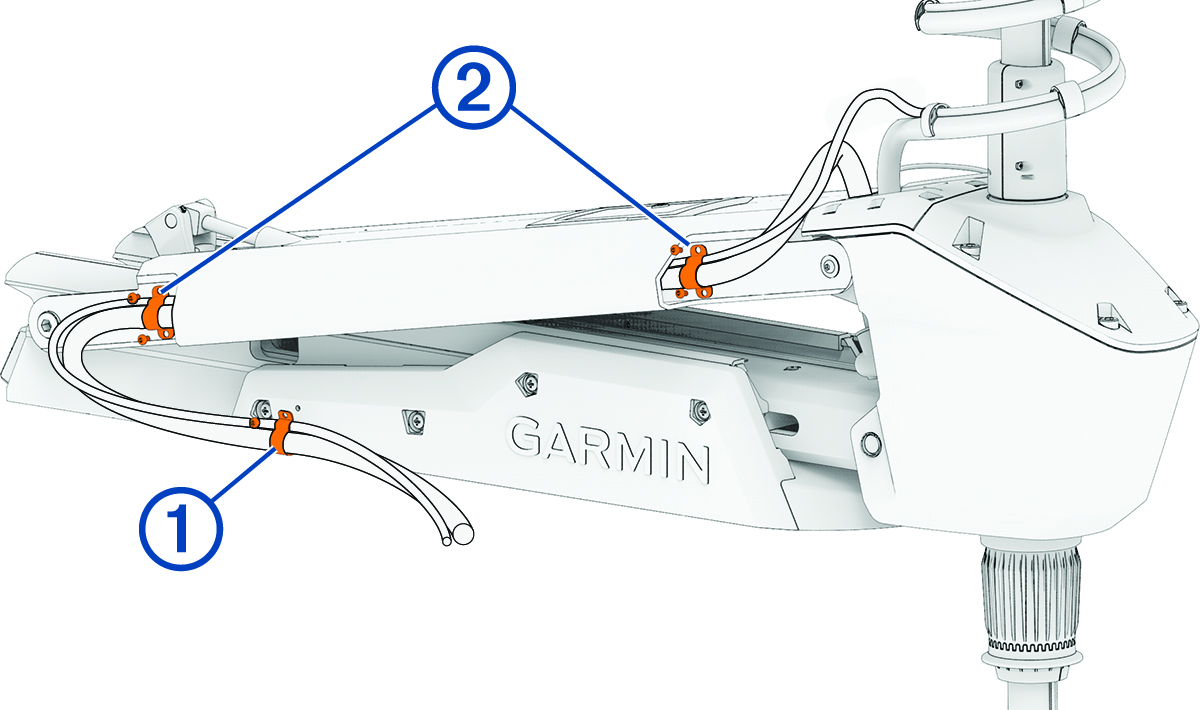

  3. Using a #1 Phillips screwdriver, remove the single screw that secures the cable clamp Callout number 1 to the shroud.
    Cable clamp locations with callouts
  4. Using a 3 mm hex bit or wrench, remove the screws that secure the two cable clamps Callout number 2 to the upper link.
  5. Pull the power cable out of the channel along the side of the mount.
  6. Pull the transducer cable out of the channel along the side of the mount.
