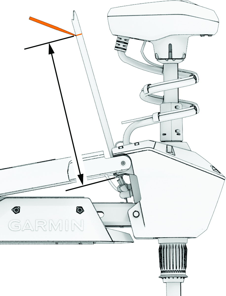

  1. Measure approximately 40 cm (16 in.) on the power cable from where it connects to the steering system, and look for the mark on the cable applied at the factory.
    Marking the power cable length
  2. If you do not see a mark on the cable, or if the mark is not approximately 40 cm (16 in.) from the connection, make a mark with a marker or tape.

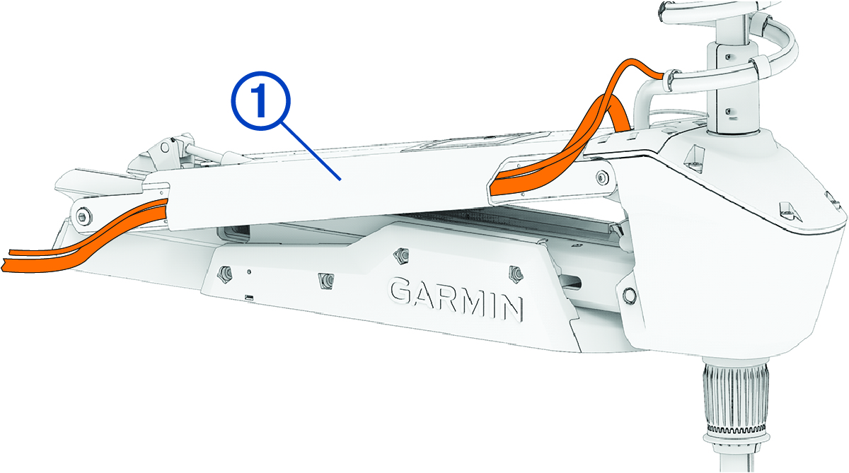

  3. With the motor in the deployed position, route the transducer cable through the channel along the right (starboard) side of the mount Callout number 1.
    Cable routing with callout
    TIP: To determine the right (starboard) side of the mount, stand in a location where you can read the information on the display panel.
  4. Route the power cable through the channel above the transducer cable.

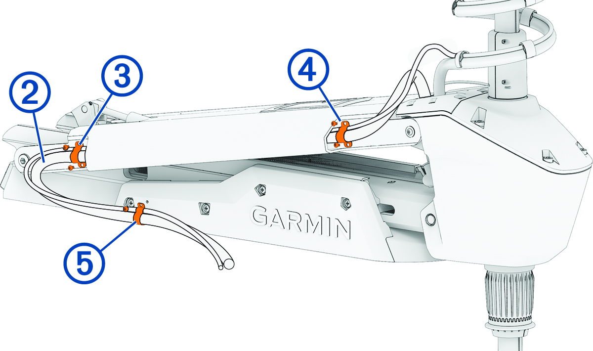

  6. Leaving a rounded bend in the cables Callout number 2, hold them against the side of the mount where they enter the channel.
    Close-up view of cable bracket with callouts
  7. At the marked location on the power cable, place one of the brackets Callout number 3 that have two screw holes over the cables and against the mount, aligning the holes on the bracket with the holes on the mount.
  8. Using a 3 mm hex bit or wrench, secure the bracket to the mount using two screws.
  9. Hold the cables against the bottom of the mount where they exit the channel.
  10. Place the other bracket Callout number 4 that has two screw holes over the cables and against the mount, aligning the holes on the bracket with the holes on the mount.
  11. Using a 3 mm hex bit or wrench, secure the bracket to the mount using two screws.
  12. Hold the cables against the plastic portion of the mount base, close to the boat deck.
  13. Insert the lower tab on the remaining bracket into a slot below the cables Callout number 5, and rotate the bracket toward the mount base to hold the cables.
  14. Using a #1 Phillips screwdriver, secure the upper tab of the bracket to the mount base using a single screw.
