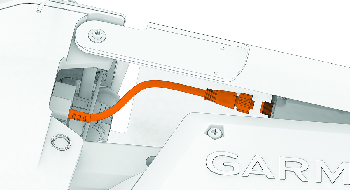

  1. With the motor in the deployed position, disconnect the cable from the display panel on the upper link of the mount.
    Disconnecting display panel

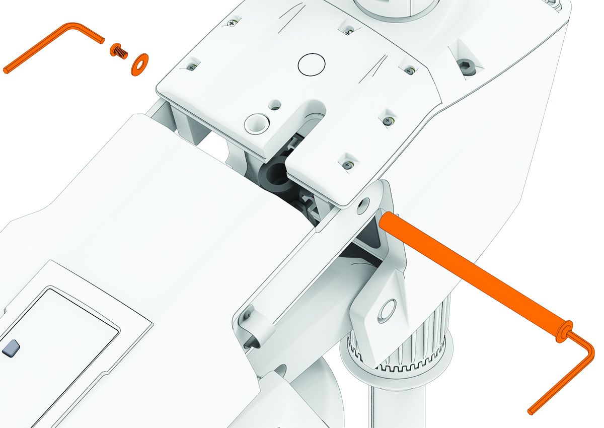

  2. Using a 4 mm hex bit or wrench, remove a screw and washer from one side of the upper pin on the steering system.
    TIP: You should use another 4 mm hex wrench on the other end of the pin to prevent it rotating while you remove the screw.
    Removing upper link pivot pin
  3. Remove the upper pin from the steering system.
  4. Pivot the upper link away from the steering system.
