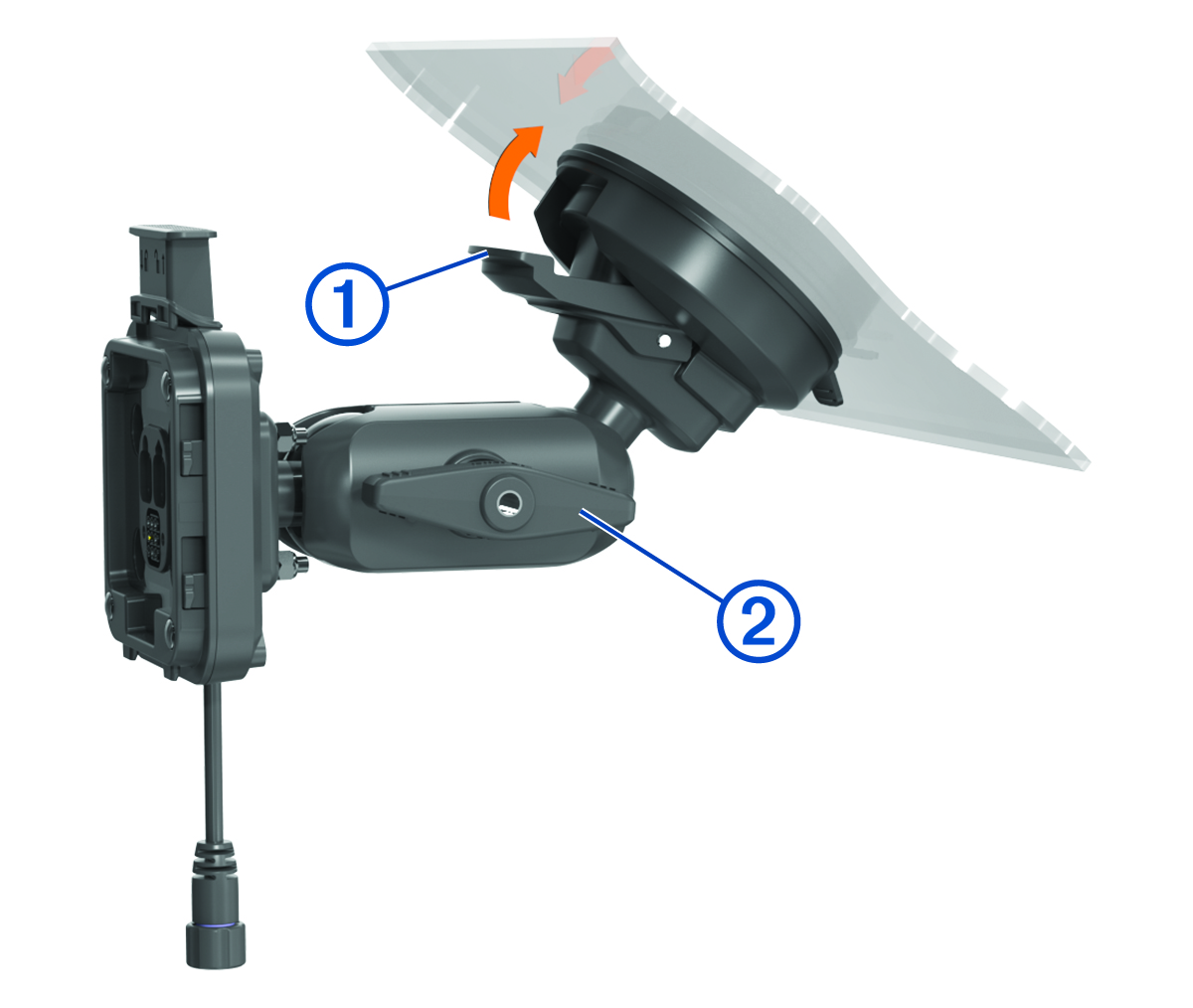

  1. Open the lever 1, press the suction cup to the windshield, and flip the lever back toward the windshield.
    The lever must be oriented toward the top of the windshield.
    Mount and suction cup attaching to the windshield with callouts
  2. Tighten the knob 2 slightly.
  3. If necessary, adjust the mount for better viewing and operation.
  4. Tighten the knob to secure the mount.

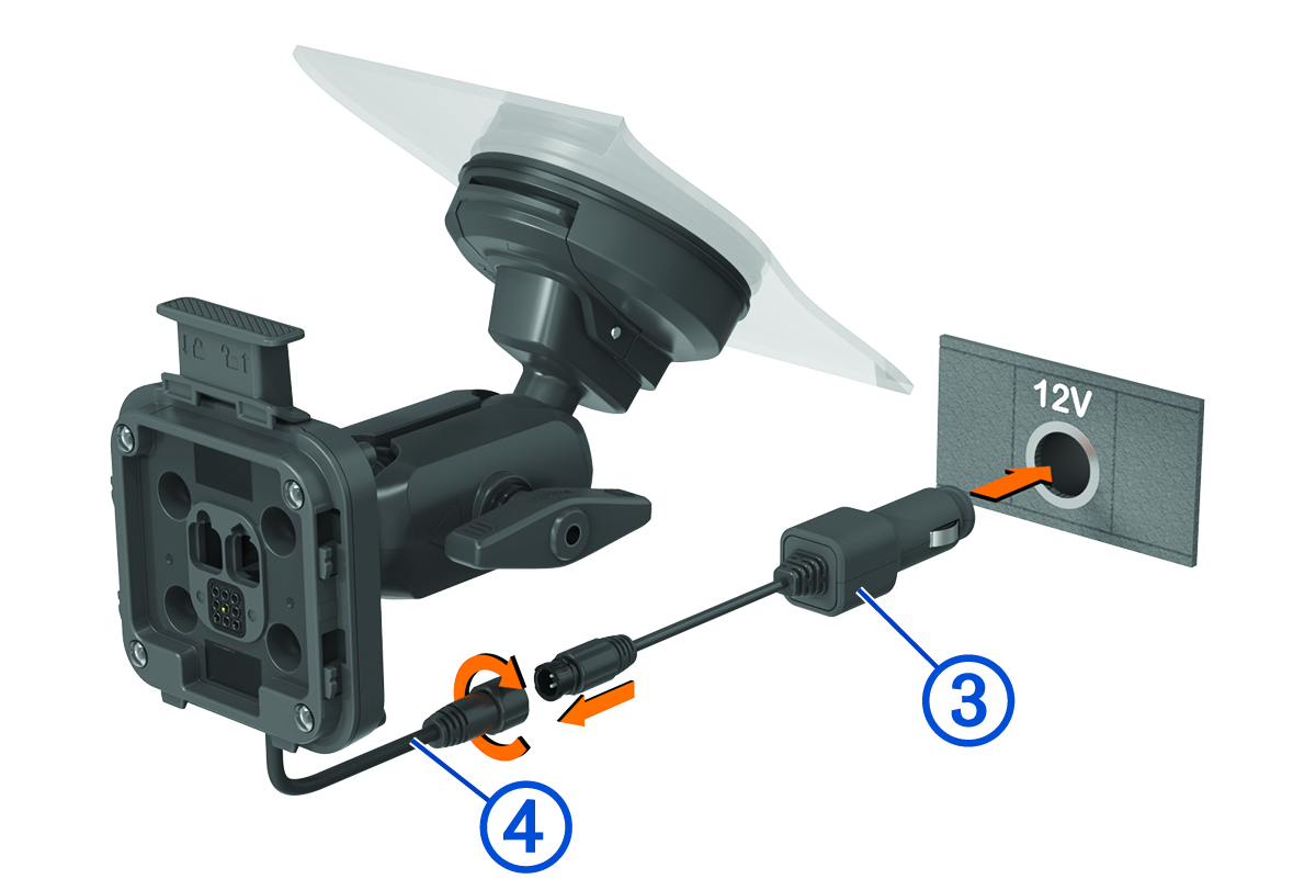

  5. Connect the vehicle power cable 3 to the cable 4 on the mount.
    Mount connecting to vehicle power with callouts
  6. Tighten the collar around the connected power cables.
  7. Plug the other end of the vehicle power cable into a power outlet in your vehicle.

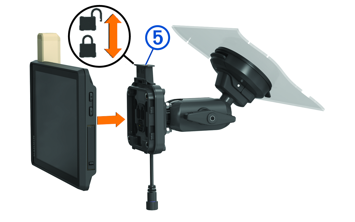

  8. Place the device onto the magnetic mount.
    Device connecting to the mount with a callout
  9. Push down the lock 5 to secure the device to the mount.
