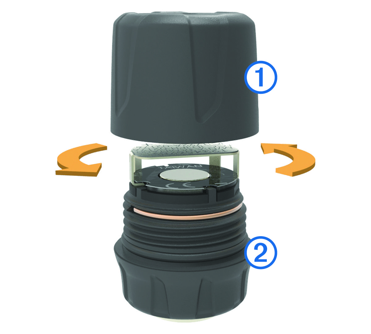

  1. Remove the cap Callout number one from the sensor Callout number two by rotating the cap counter-clockwise.
  2. If you have already installed the battery in the sensor, remove the battery.

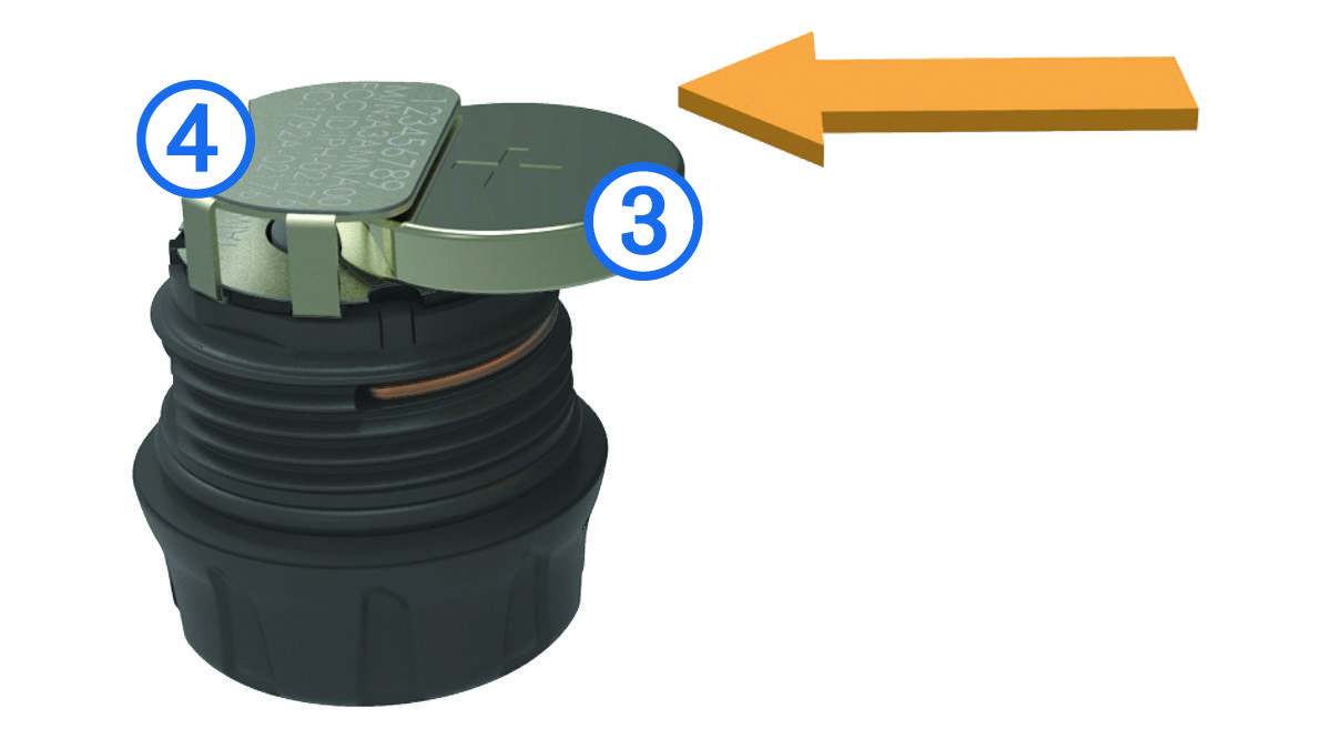

  7. Within 30 seconds, on the sensor, insert the battery Callout number three into the battery holder Callout number four with the positive side facing up.
    The zūmo device searches for the sensor and displays a confirmation message when the sensor pairs successfully.
