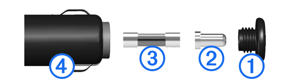

When replacing the fuse, do not lose any of the small pieces and make sure they are put back in the proper position. The vehicle power cable does not work unless it is assembled correctly.
If your device does not charge in your vehicle, you may need to replace the fuse located at the tip of the vehicle adapter.
  1. Unscrew the end piece Callout number one.
    Fuse with callouts
  2. Remove the end piece, the silver tip Callout number two, and the fuse Callout number three.
  3. Insert a new 3 A fast-blow fuse.
  4. Place the silver tip in the end piece.
  5. Screw the end piece back into the vehicle power cable Callout number four.
