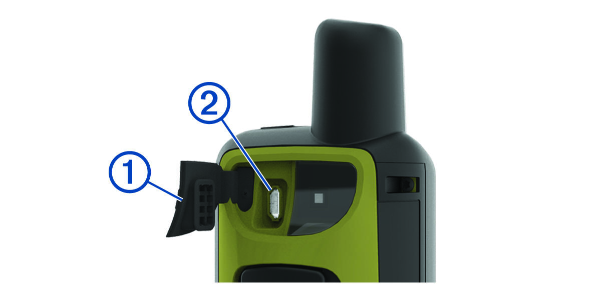

  1. Lift the weather cap 1.
    USB port with callouts
  2. Plug the small end of the power cable into the charging port 2 on the device.
  3. Plug the other end of the power cable into a compatible AC power adapter.
  4. Plug the AC power adapter into a standard wall outlet.
  5. Charge the device completely.
