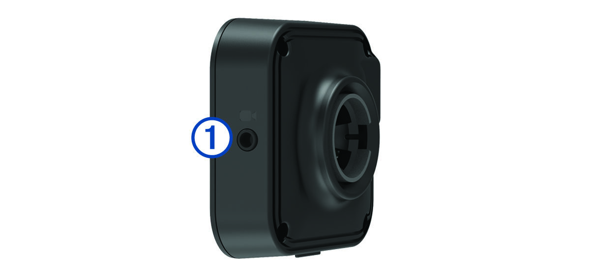

To connect a wired backup camera, you must purchase an optional video mount accessory, which includes a 3.5 mm composite video input jack. Go to garmin.com to purchase an accessory mount.
You can connect a wired backup camera and view the output on the device screen.
  1. Replace the original device mount with the video mount accessory.
  2. Plug the camera video cable into the video input jack Callout number one on the mount.
    Video input jack and callout
