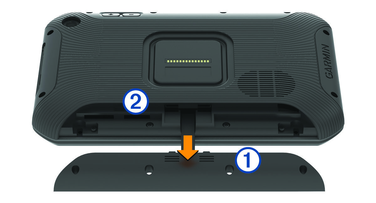

  1. Press on the two marked areas, and slide the back panel Callout number one down to open it.
  2. Locate the memory card slot Callout number two.
  3. Press the existing memory card in until it clicks, and release it.
    The existing memory card ejects from the slot.
  4. Remove the existing card from the slot
  5. Insert the new memory card into the slot.
  6. Press the card in until it clicks.
  7. Replace the panel, and slide it upward until the panel clicks into place.
