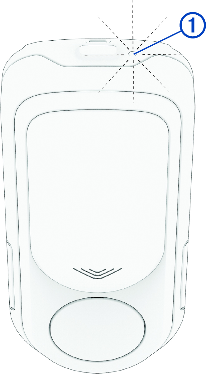

Charging Status LED
NOTE: The status LED 1 flashes to indicate the current charge status when the device is charging and turned off. If the device is charging and turned on, the normal operating status LED patterns apply (Status LED).
Device status LED with a callout
Flashing Green rapidly
The device is less than 15% charged.
Flashing Green
The device is between 15% and 99% charged.
Solid Green
The device is fully charged.
