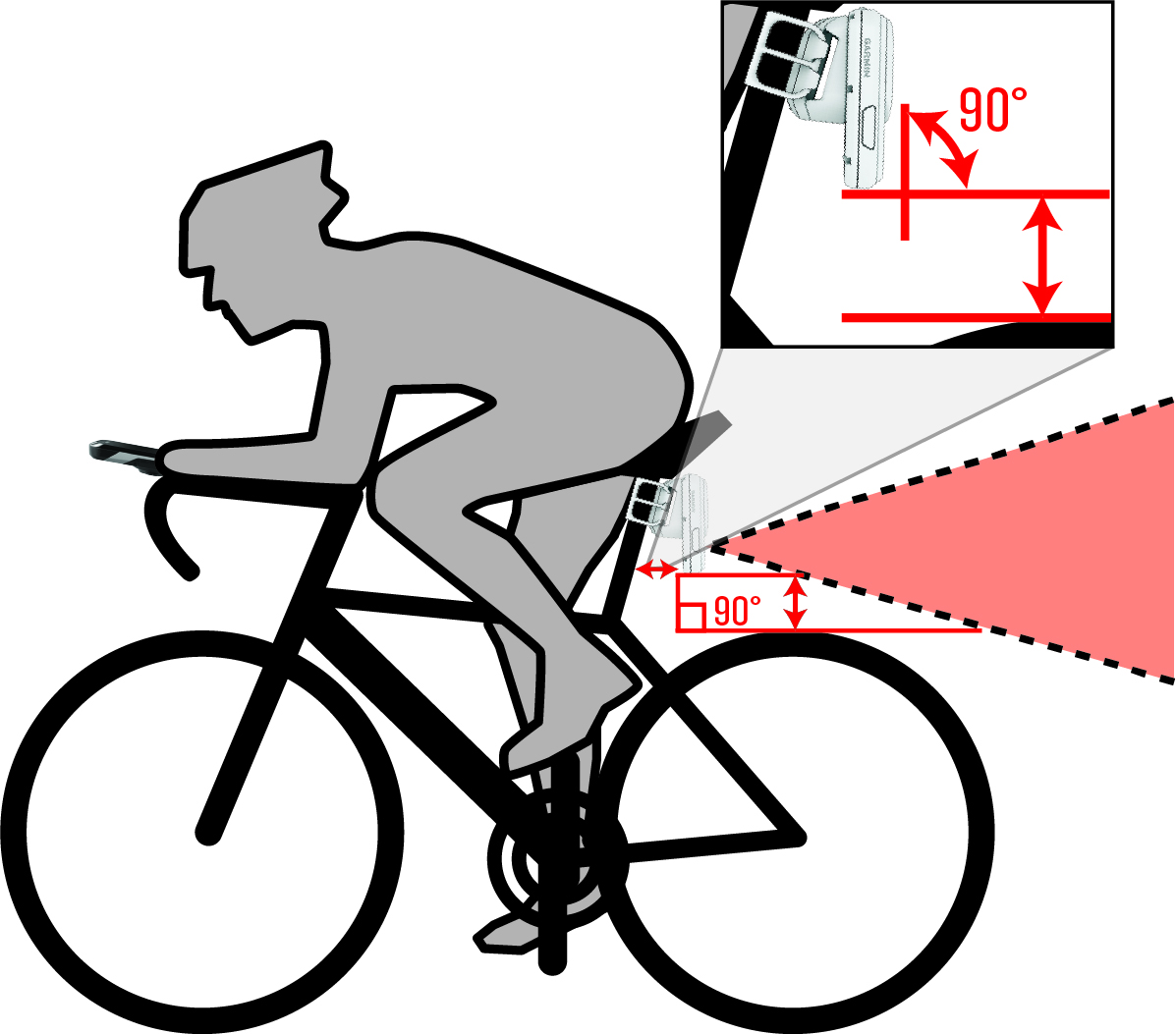

To ensure maximum tail light visibility and radar detection range, you should install the mount according to these considerations.
  • Make sure the device does not interfere with the safe operation of your bike.
  • Install the mount as high as possible on the bike.
  • Mount the device 250 to 1200 mm above the road.
  • Mount the Varia™ RearVue 820 device parallel to the longitudinal axis of the vehicle.
  • Make sure there are no obstructions that may block the tail light or the radar.
  • Make sure the mount surface is perpendicular to the road.
    Device mounted on a bike

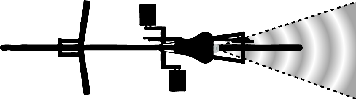

  • Make sure the device faces straight back, so that the radar beam covers the maximum range behind your bike.
    Overhead view of radar beam
