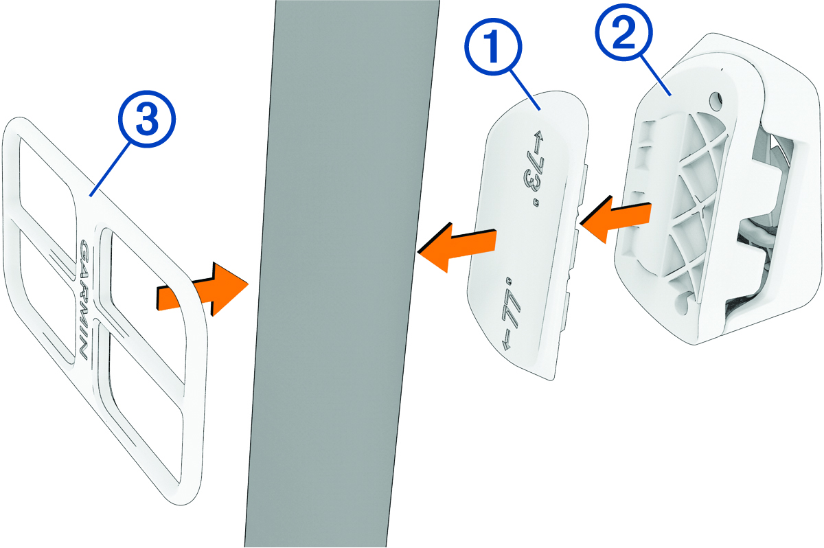

  1. Select the rubber pad 1 that best fits the shape of your seat post.
    Seat post mount with callouts
  2. Select an option to place the pad on the mount 2:
    • If one of the numbers marked on the pad matches the angle of your seat post, place the pad on the mount with the correct angle number up.
    • If neither of the numbers on the pad matches the angle of your seat post, or if you don't know the angle of your seat post, test both pad orientations, and select the best one.
    The combined mount and pad must result in the device being perpendicular to the road surface, to maximize your radar range and tail light visibility.
  3. Place the mount on the seat post.
  4. Secure the mount to the seat post using one of the included bands 3.
    NOTE: You can secure the mount using the included cable ties instead of the band.
