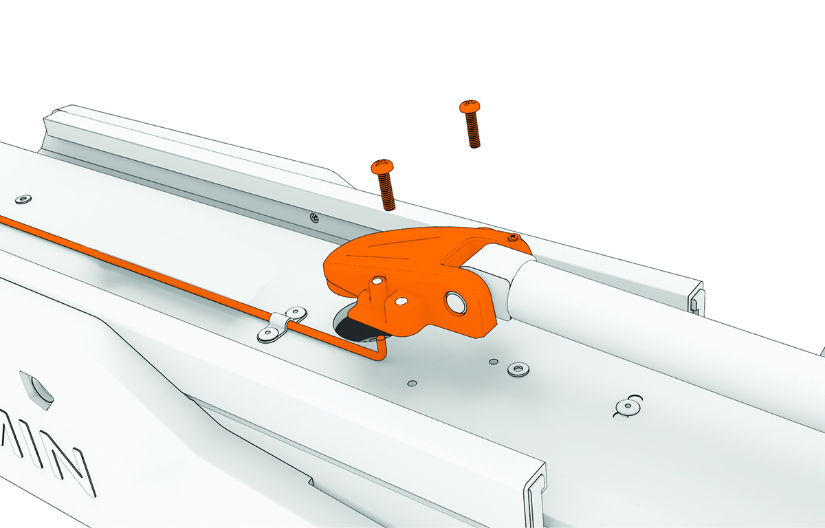

  1. Using a #2 Phillips screwdriver, remove the two screws that secure the lower gas spring clevis to the lower link of the mount.
    Upper gas spring exploded view
  2. Lift the upper gas spring clevis off of the safety rod.
