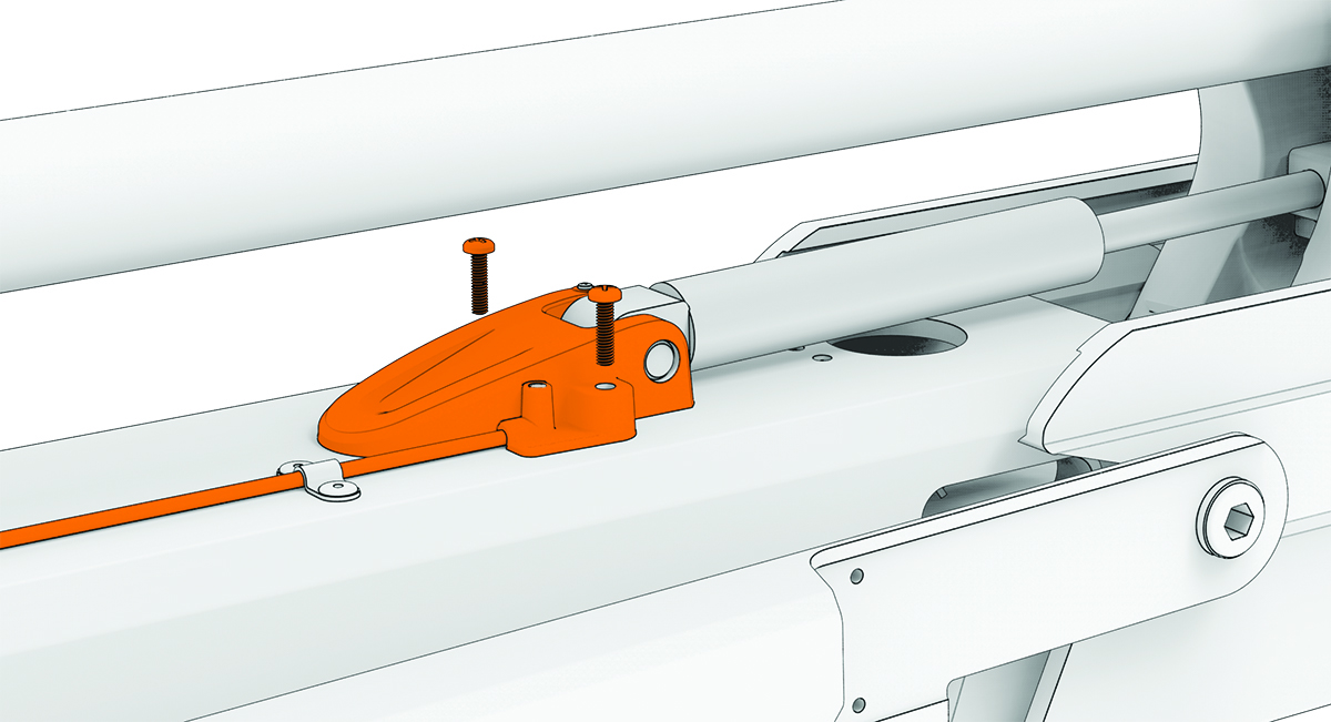

Disconnecting the Lower Gas Spring Place the trolling motor in the stowed position. Using a #2 Phillips screwdriver, remove the screws that secure the lower gas spring clevis to the lower link of the mount. Lift the lower gas spring clevis off of the safety rod. Parent Topic: Removing the Steering System from the MountHomeService ProceduresRemoving the Steering System from the MountDisconnecting the Lower Gas Spring
