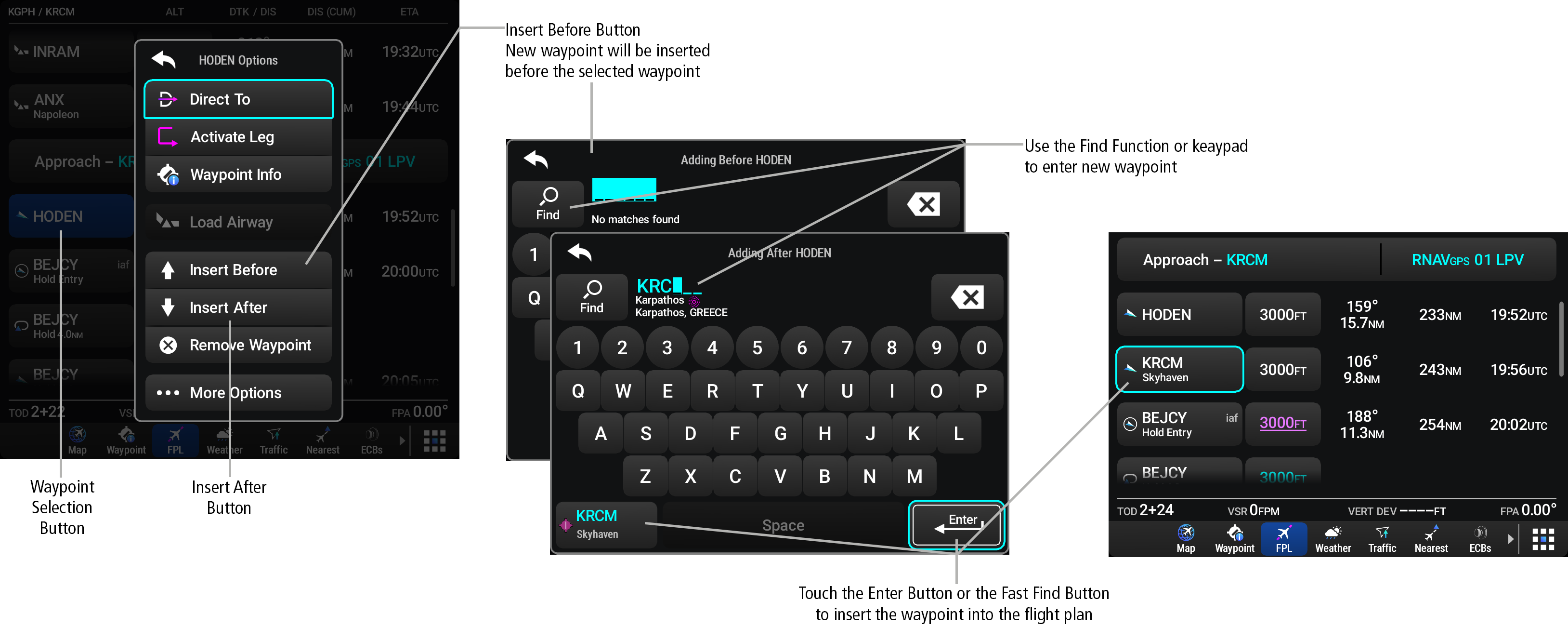

184: Inserting a Waypoint from the Active Flight Plan
Child Topics:
  • Fly-Over Waypoints
  • Adding A Waypoint To A Flight Plan:
  • Adding A Waypoint To The Active Flight Plan From 'Waypoint Info':
  • Adding A Waypoint Into The Active Flight Plan Using The Nearest Button:
  • Adding A Waypoint To The Active Flight Plan Using The Map Radial Menu:
