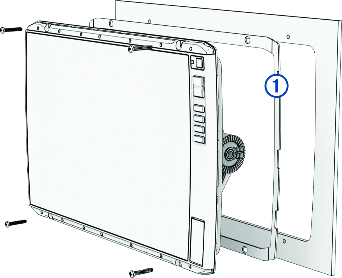

  10. Place the device in the cradle (Installing the Device in the Cradle).
  11. Install the rubber gasket Callout number 1 on the back of the device.
    The rubber gasket has adhesive on the back. Make sure you remove the protective liner before installing it on the device.
    Device flush mount installation with a callout
  12. Connect all necessary cables (Connector View), and spin the locking rings clockwise to secure the cables to the cradle before placing it into the cutout.
    NOTICE
    To prevent corrosion of the metal contacts, cover unused connectors with weather caps.
  13. Place the device into the cutout.
  14. Secure the device to the mounting surface using the included screws.
  15. Install the trim caps by snapping them in place around the edges of the device.
