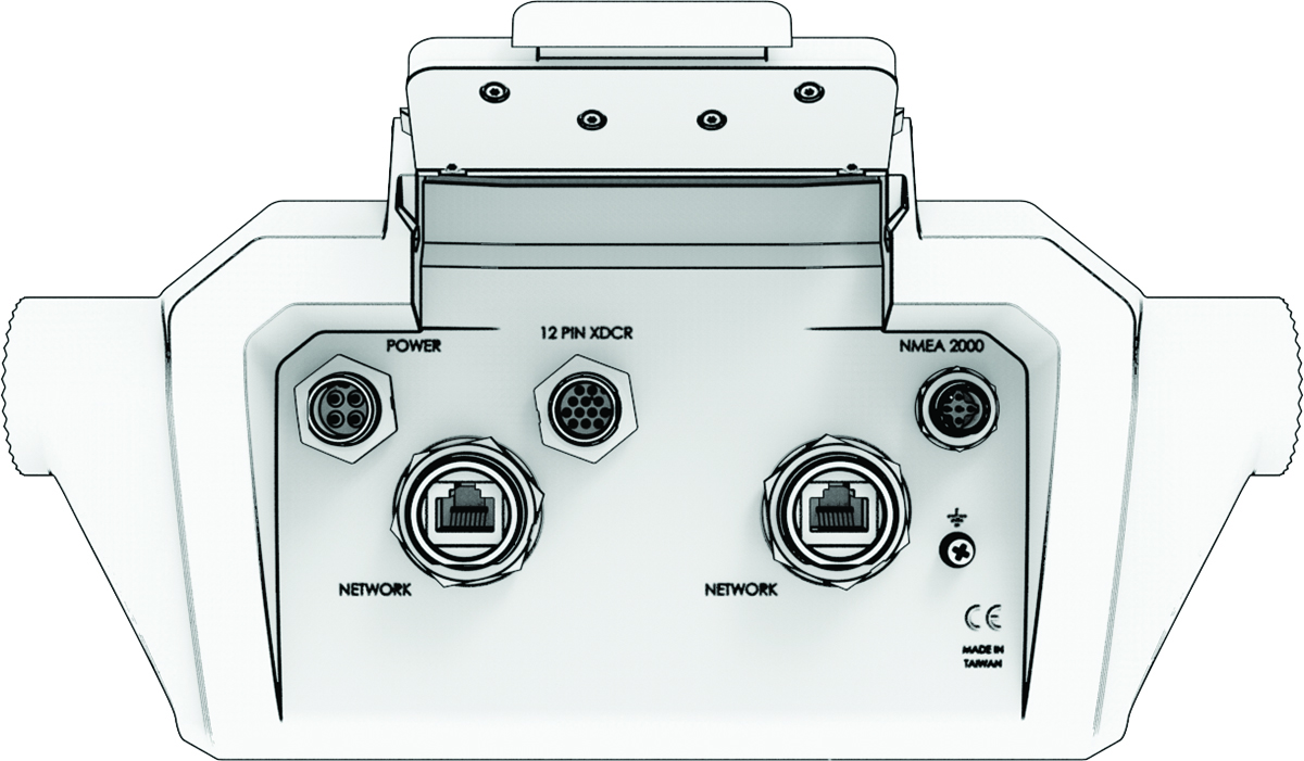

Connector View
Device connector view with callouts
Label
Description
POWER
Power cable port
12 PIN XDCR
12-pin transducer
NMEA 2000
NMEA 2000® network
NETWORK
Garmin® network cable port for connection to compatible Panoptix™, GCV™, and ECHOMAP™ devices
NOTE: This device is not compatible with some Garmin Marine Network devices such as GPSMAP®, GSD™, and radar devices.
Power ground symbol
Ground screw
NOTICE
To prevent corrosion of the metal contacts, cover unused connectors with weather caps.
NOTICE
For best performance and to prevent corrosion, insert the cable connector fully into the port and turn the locking ring clockwise to tighten it. If the split-collar locking ring is not installed, you must install it.
