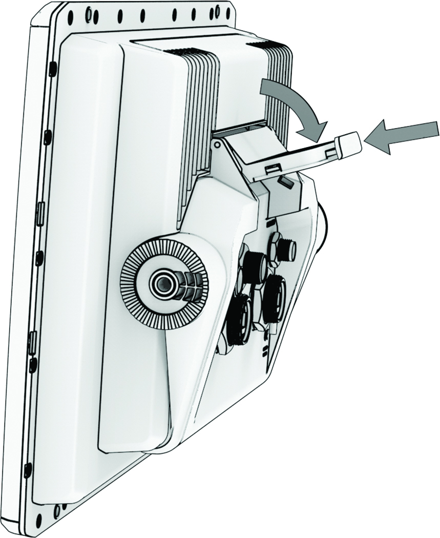

Installing the Device in the Cradle
After the cables are connected to the cradle, you can quickly place the device in the cradle.
  1. Press the button on the release lever and lift the lever to unlock it.
  2. Place the base of the device in the bottom of the cradle.
  3. Lift the lever.
  4. Tilt the top of the device toward the cradle.
    Device installation in the cradle
  5. Press the button on the lever, and push the lever down until the device clicks in place.
