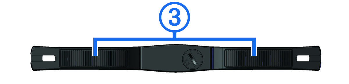

  3. Wet the electrodes Callout number three on the back of the module to create a strong connection between your chest and the heart rate monitor module.
    Back of the device with a callout
