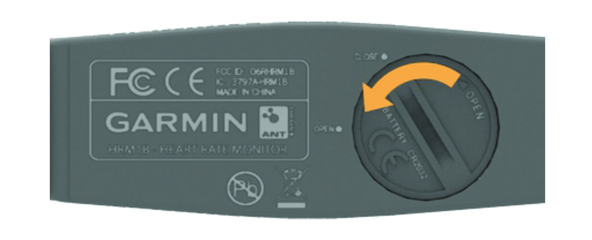

  1. Locate the circular battery cover on the back of the heart rate monitor.
    Battery cover
  2. Use a coin to twist the cover counter-clockwise until it is loose enough to remove (the arrow points to OPEN).
  3. Remove the cover and the battery.
  4. Wait 30 seconds.
  5. Insert the new battery with the positive side facing up.
    NOTE: Do not damage or lose the O-ring gasket.
  6. Use a coin to twist the cover clockwise back into place (the arrow points to CLOSE).
