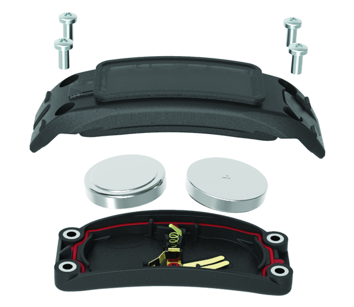

  3. Remove the cover and batteries.
    Exploded view of the device and batteries

  5. Insert the new batteries.
    NOTE: Do not damage or lose the gasket.
  6. Replace the front cover and the four screws.
  7. Tighten the four screws equally and firmly.
