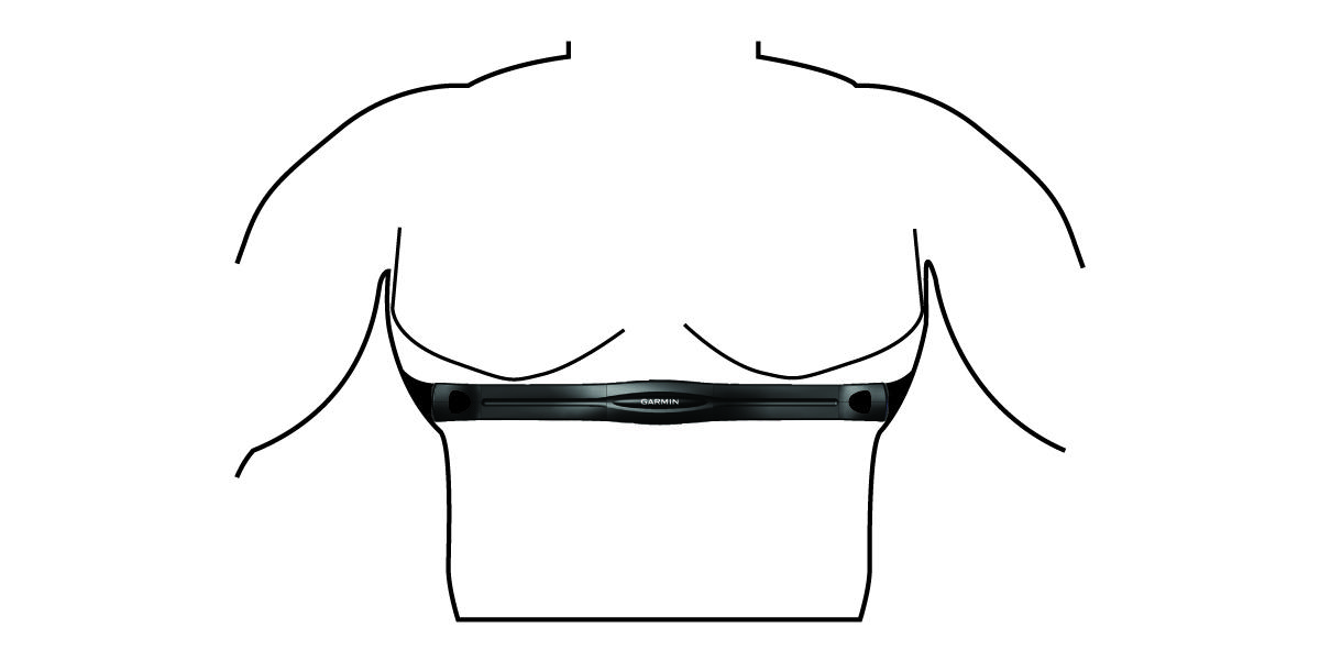

You should wear the heart rate monitor directly on your skin, just below your sternum. It should be snug enough to stay in place during your activity.

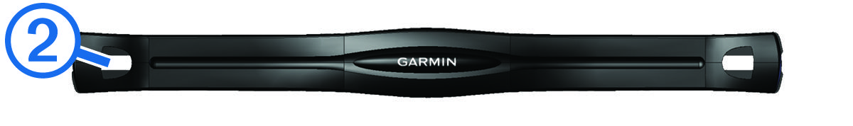

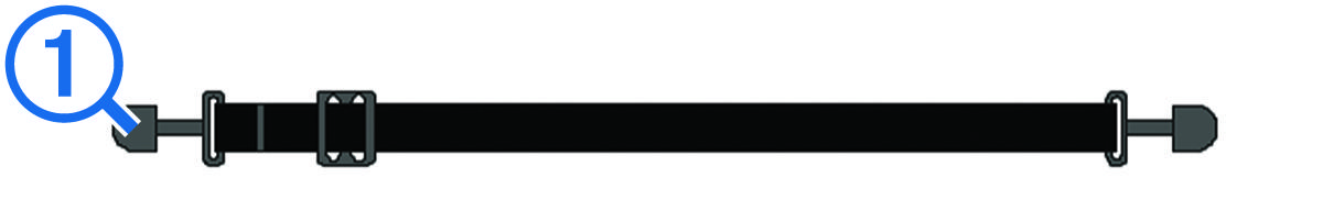

  1. Push one tab Callout number one of the strap through the slot Callout number two in the heart rate monitor module.
    Strap with a callout
    Heart rate monitor with a callout
  2. Press the tab down.

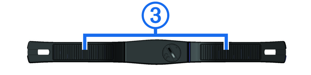

  3. Wet the electrodes Callout number three on the back of the module to create a strong connection between your chest and the heart rate monitor module.
    Electrodes with a callout
  4. Wrap the strap around your chest and attach it to the other side of the heart rate monitor module.
    Device placement on the chest
    The Garmin® logo should be right-side up.
