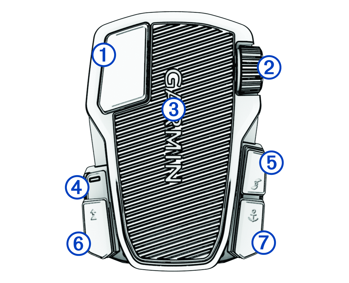

Foot Pedal
1
Momentary propeller control
Hold to turn on the propeller at the set speed.
Release to turn off the propeller.
2
Speed wheel
Rotate the wheel away from you to increase the propeller speed or cruise control speed.
Rotate the wheel toward you to decrease the propeller speed or cruise control speed.
NOTE: The speed wheel is inactive when anchor lock is on.
3
Steering pedal
Push the pedal with your toes to turn the motor clockwise.
Push the pedal with your heel to turn the motor counter-clockwise.
NOTE: When anchor lock or heading hold is on, or you are following a route, tilt the pedal or press a button to resume manual control at the previous propeller speed.
4
Status LED
Shows the status of the foot pedal (Status Indicator).
5
Propeller icon
Continuous propeller control
Press once to turn the propeller on or off (Turning the Propeller On and Off).
Press twice to turn off any autopilot function (if enabled), stop the propeller, and shift between forward and reverse thrust (Reverse Thrust).
6
Heading hold icon
Heading hold
Press once to set and maintain the current heading (Maintaining Your Heading).
Press again to turn off heading hold, stop the propeller, and resume manual control.
TIP: You can disable this button by pressing it six times. You can press it six times again to re-enable it.
7
Anchor icon
Anchor lock
Press to turn on anchor lock. Anchor lock uses the trolling motor to hold your position (Holding Your Position).
Press again to turn off anchor lock and return to the previous steering mode.
