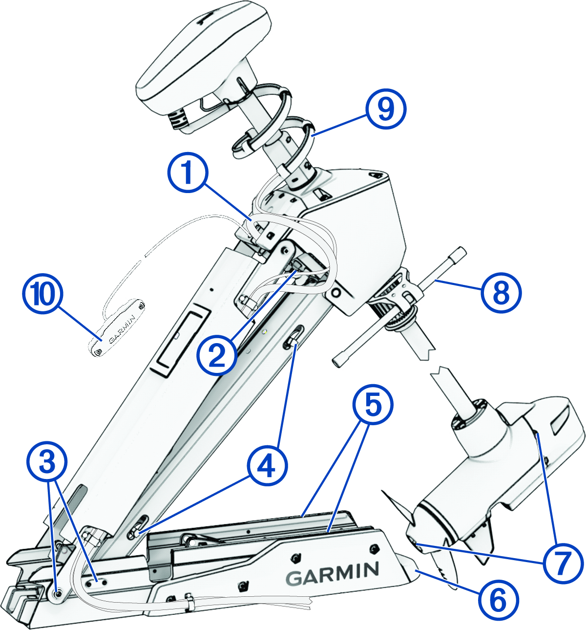

  • Examine the power cable 1 for wear, and replace it if necessary.
  • Check and clean the power terminals and tighten the nuts 2, if necessary (Checking and Cleaning the Power Terminals).
  • Lubricate the hinges and bushings 3 (Lubricating the Hinges and Bushings).
  • Clean and lubricate the stow and deploy latch mechanism 4 (Cleaning and Lubricating the Locking Mechanism).
  • Check the mount rails 5, and replace them if necessary (Checking and Replacing the Mount Rails).
  • Check the mount bumper 6, and replace it if necessary (Checking and Replacing the Mount Bumper).
  • Clean or replace the anodes in the propeller drive motor 7 (Servicing the Anodes).
  • If installed, check the rubber stops on the ends of the stabilizer 8 for wear and replace them as necessary.
  • Examine the coil cable 9 for wear, and replace it if necessary.
  • Examine the pull-cable and handle 10 for wear, and replace it if necessary (Replacing the Pull Cable).
