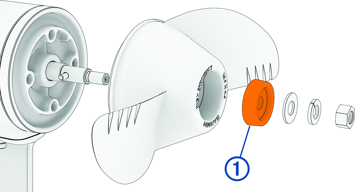

Servicing the Propeller Anode
  1. Using a 9/16 in (15 mm) socket, loosen the nut on the end of the propeller.
  2. Remove the propeller and set aside the nut, the lock washer and the flat washer.
  3. Remove and examine the anode 1.
    Propeller anode location with callout
  4. Select an option:
    • If the anode is half of the original size or larger, clean the anode using a wire brush or sandpaper.
      NOTICE
      Remove the anode from the motor before cleaning it with a wire brush or sandpaper. Cleaning the anode while installed on the motor could damage the motor, accelerate corrosion, and shorten the life of the motor.
    • If the anode is smaller than half of the original size, discard the anode and purchase a replacement.
  5. Place the cleaned or new anode back on the propeller drive shaft, followed by the flat washer, the lock washer and the nut.
  6. Using a 9/16 in (15 mm) socket, tighten the nut to 16.27 N-m (12 lbf-ft) to secure the propeller.

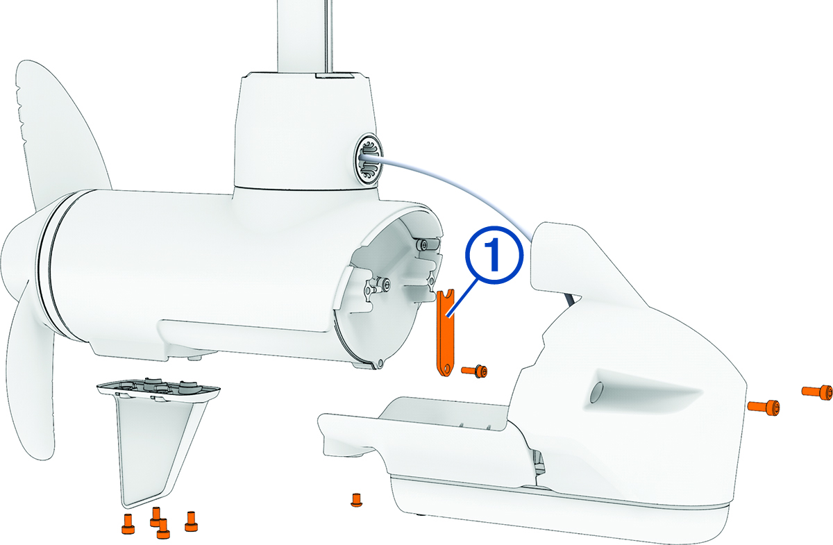

Servicing the Nose Cone Anode
NOTE: Trolling motors built after 2024 use two screws to secure the anode to the propeller drive motor housing. If your replacement anode has two holes, but your propeller drive motor only has one hole, you can install the new anode using only one screw, and discard the other screw.
  1. Using a 4 mm hex bit or wrench, remove the four screws securing the skeg on the bottom of the motor.
  2. Using a 3 mm hex bit or wrench, remove the screw that secures the transducer and nose cone to the bottom of the motor .
  3. Using a 4 mm hex bit or wrench, remove the screws to disconnect the nose cone from the front of the motor.
  4. Using a 3 mm hex bit or wrench, uninstall the anode 1 on the front of the motor.
    Nose cone anode location with callout
  5. Examine the anode, and complete an action:
  6. Secure the new or cleaned anode to the propeller drive motor using one or two screws.
    NOTE: If your propeller drive motor has two mounting points for the anode, you should always use two screws to secure the anode.
  7. Reinstall the nose cone, using two screws to secure it to the front of the propeller drive motor.
  8. Reinstall the screw that secures the transducer and nose cone to the bottom of the propeller drive motor.
  9. Reinstall the skeg on the bottom of the propeller drive motor.
