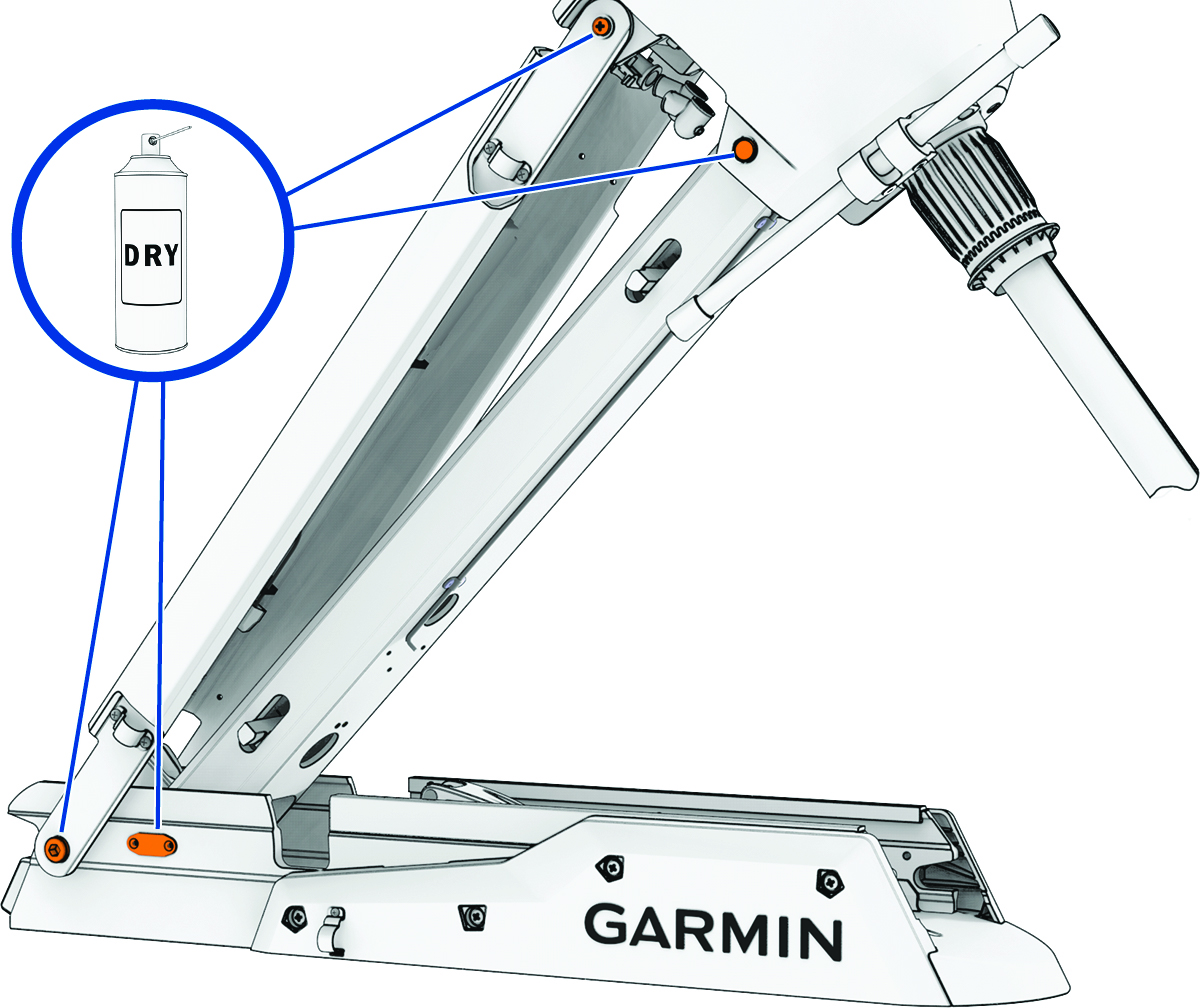

Lubricating the Hinges and Bushings
  1. Apply a non-stick, dry-film lubricant to each hinge point, including the space between the moving parts.
    Hinge pivot points
  2. Move the motor from the stowed to the deployed position and back a few times to distribute the lubricant.
  3. If necessary, apply additional lubricant and repeat the previous step.
  4. Allow the lubricant to dry according manufacturer's instructions.
