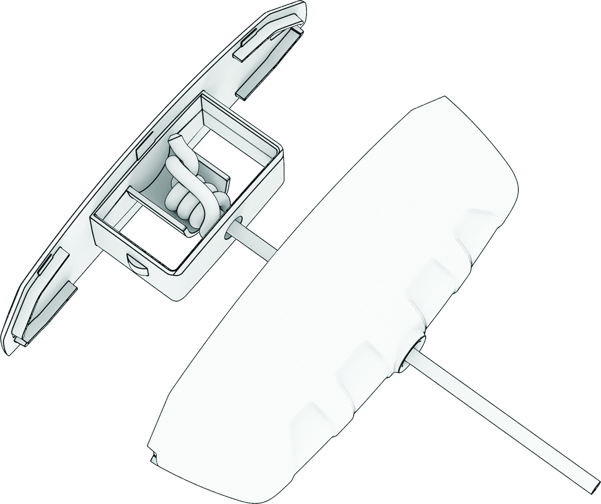

Installing the Rope Handle
  1. Feed the end of the rope through the two pieces of the pull handle.
  2. Trim the rope, allowing enough slack to make sure you can comfortably reach it from your position seated in your kayak.
    TIP: We recommend trimming the rope to about 20 cm (8 in.) from the cleat, so the pull handle will stay close to the cleat when the motor is in the deployed position.
  3. Tie a stopper knot to bind the rope inside the pull handle.
  4. If necessary, trim and melt the end of the rope to prevent fraying.
  5. Snap the two pieces of the pull handle together.
    Rope in the rope handle with knot
