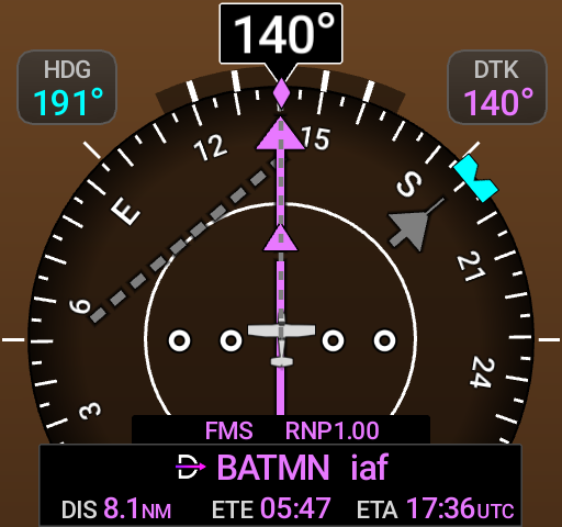

The HSI contains a Course Deviation Indicator (CDI), with a Course Pointer, To/From Indicator, and a sliding deviation bar and scale. The course pointer is a single line arrow (FMS1, GPS1, VOR1, and LOC1) or a double line arrow (FMS2, GPS2, VOR2, and LOC2) which points in the direction of the set course or VOR radial. The To/From arrow rotates with the course pointer and is displayed when the active NAVAID is received.
The Course Deviation Indicator (CDI) moves left or right from the course pointer along a lateral deviation scale to display aircraft position relative to the course. If the course deviation data is not valid, the CDI is not displayed.
The CDI is located in the center of the standard HSI compass card, and is duplicated using a standalone CDI bar above the HSI.
66: Lateral Deviation Scale

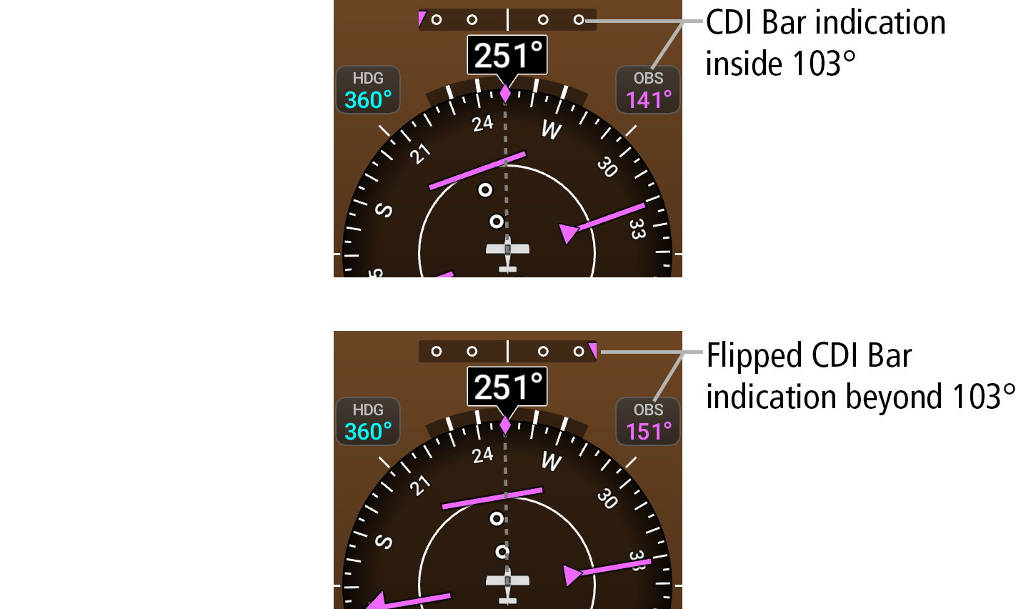

NOTICE
The standalone CDI bar deviation will change sides when the current aircraft heading is more than 103° from the inbound course to the station to accurately reflect the HSI CDI direction of deflection.
67: Changing Sides of the CDI Bar Deviation Scale
The CDI is capable of displaying two different sources of navigation: GPS/FMS or NAV (VOR, localizer) depending on the navigator(s) configured (refer to the AXIS™ installation manual for more information). Color indicates the current navigation source: magenta (for GPS) or green (for VOR and LOC). The full-scale limits for the CDI are defined by a GPS-derived distance when coupled to GPS. When coupled to a VOR or localizer (LOC), the CDI has the same angular limits as a mechanical CDI. If the CDI exceeds the maximum deviation on the scale (two dots) while coupled to GPS, the crosstrack error (XTK) is displayed below the white aircraft symbol.
