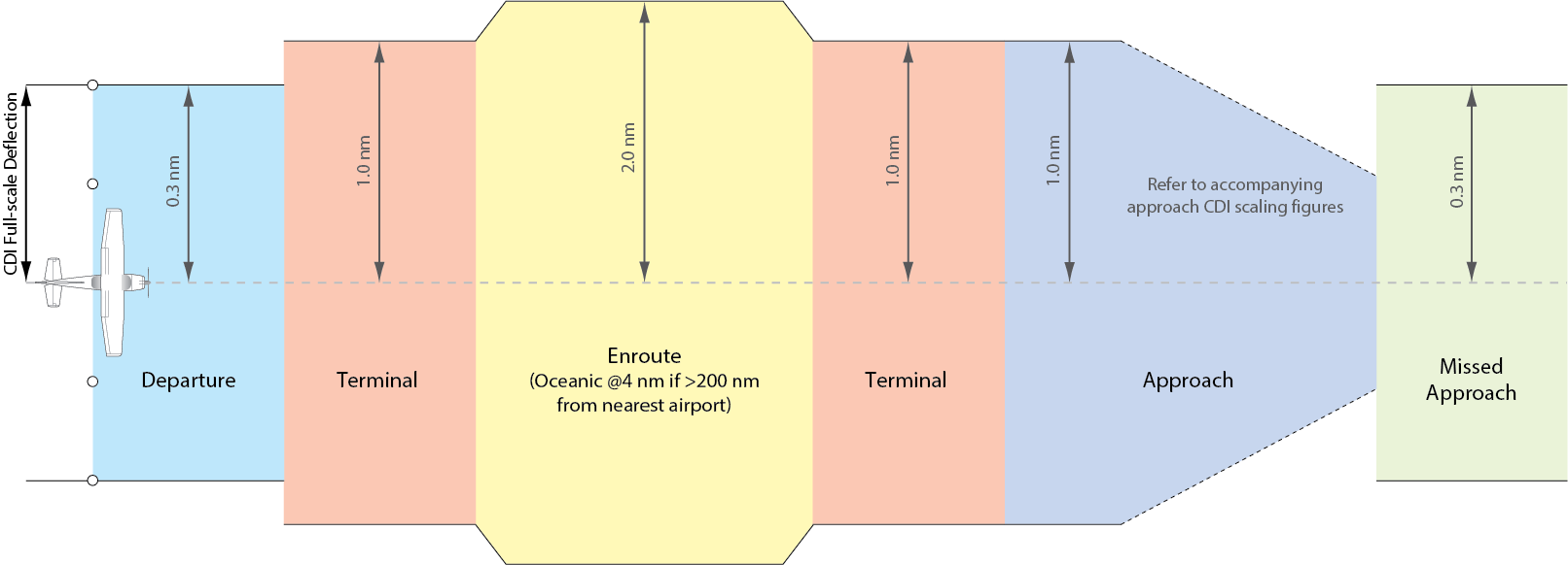

When a flight plan is active, the flight plan legs and CDI are sequenced automatically based upon the current phase of flight. The CDI scale is set to automatically adjust the Required Navigation Performance (RNP) for each phase of flight. A cross track annunciation will appear below the aircraft symbol on the HSI when the CDI exceeds the current RNP value.
69: Automatic CDI Scaling
  • Once a departure procedure is activated, the CDI is scaled for departure (0.3 NM).
  • The system switches from departure to terminal CDI scaling (1.0 NM) under the following conditions:
    • The next leg in the departure procedure is not aligned with the departure runway.
    • The next leg in the departure procedure is not a CA, CD, CF, CI, CR, DF, FA, FC, FD, FM, IF, or TF (see Aviation Terms and Acronyms in Appendix C for leg type definitions).
    • After any leg in the departure procedure that is not a CA or FA.
  • At 30 NM from the departure airport, the enroute phase of flight is automatically entered and CDI scaling changes to 2.0 NM, except under the following conditions:
    • When navigating with an active departure procedure, the flight phase and CDI scale does not change until the aircraft arrives at the last departure waypoint (if more than 30 NM from the departure airport) or the leg after the last departure waypoint has been activated or a direct-to waypoint is activated.
  • If after completing the departure procedure the nearest airport is more than 200 NM away from the aircraft and the approach procedure has not yet commenced, the CDI is scaled for oceanic flight (4.0 NM).
  • Within 31 NM of the destination airport (terminal area), the CDI scale gradually ramps down from 2.0 NM to 1.0 NM over a distance of 1.0 NM; except under the following conditions:
    • Upon reaching the first waypoint of an arrival route that is more than 31 NM from the destination airport, the flight phase changes to terminal and the CDI scale begins to transition down from 2.0 NM to 1.0 NM over a distance of 1.0 NM.
  • During approach, the CDI scale ramps down even further. This transition normally occurs within 2.0 NM of the final approach fix (FAF). The CDI switches to approach scaling automatically once the approach procedure is activated or if Vectors-To-Final (VTF) are selected.
  • If the active waypoint is the FAF, the ground track and the bearing to the FAF must be within 45° of the final approach segment course.
  • If the active waypoint is part of the missed approach procedure, the active leg and the preceding missed approach legs must be aligned with the final approach segment course and the aircraft must not have passed the turn initiation point.
    70: Typical LNAV, LNAV+V, and Visual Approach Service Level CDI Scaling
    71: Typical LNAV/VNAV, LP, LP+V, and LPV Approach Service Level CDI Scaling
  • When a missed approach is activated, the CDI scale changes to 0.3 NM.
  • The system automatically switches back to terminal mode under the following conditions:
    • The next leg in the missed approach procedure is not aligned with the final approach path.
    • The next leg in the missed approach procedure is not a CA, CD, CF, CI, CR, DF, FA, FC, FD, FM, IF, or TF.
    • After any leg in the missed approach procedure that is not a CA or FA.
