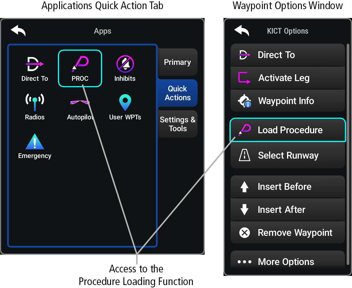

Initiating the Procedure Loading Function
The system allows the Procedure Loading Function to be accessed from multiple starting points depending on the current operation or display. The following procedures provide instruction on how to select and initiate the load of any procedure, depending on the starting point. Following discussions in this section shall assume the pilot has initiated the Procedure Loading Function and is ready to select the required settings and load the procedure in the flight plan.
207: Initiating the Procedure Loading Function
