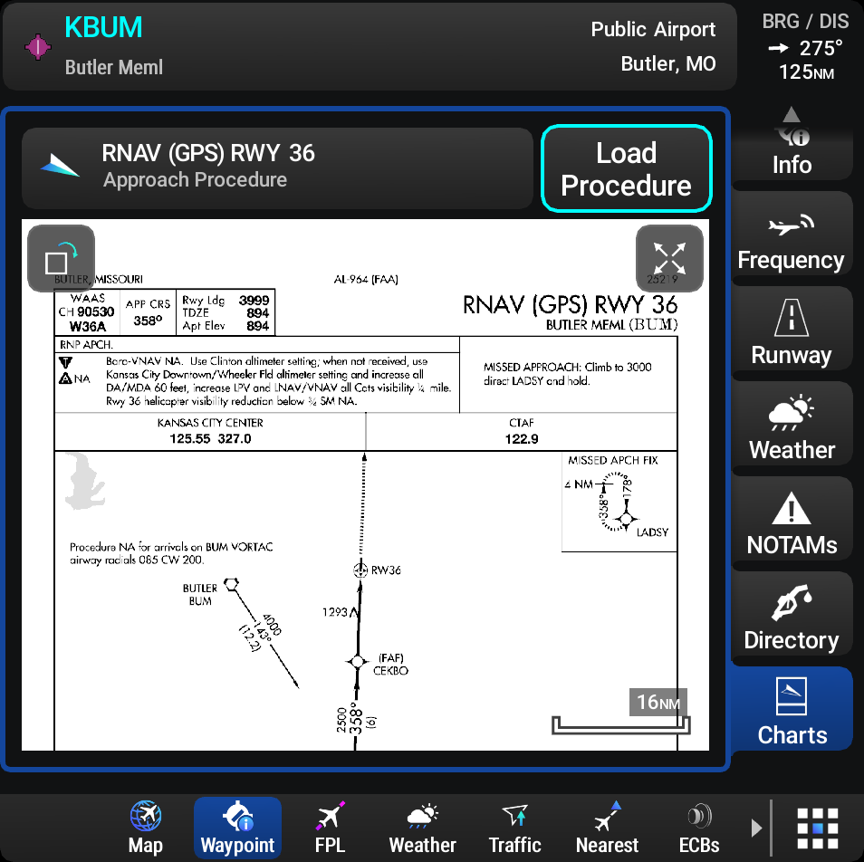

Initiating The Procedure Loading Function and Selecting A Procedure From The Waypoint Page On The MFW:
208: Initiating the Procedure Loading Function from 'Charts'
  1. On the MFW App Bar, touch the Waypoint Button.
    Or:
    Touch the Applications Icon > Waypoint Button.
  2. On the Waypoint Page, select the Charts Tab.
  3. Touch the Chart Selection Button.
  4. Select the type of procedure but touching the Departure Tab, Arrival Tab, or the Approach Tab.
  5. If necessary, scroll through the list of charts and select the desired procedure by touching the Chart Selection Button.
  6. Touch the Load Procedure Button.
  7. The system will automatically load the procedure into the Procedure Loading Function. The Load <Procedure> Button will be subdued until all required information is input into the Procedure Loading Function (i.e., Departure, Transition, and Runway).
  8. Touch the Load <Procedure> Button to add the procedure to the active flight plan for review.
    Or:
    Touch the Load and Activate Button to begin FMS navigation of the procedure.
