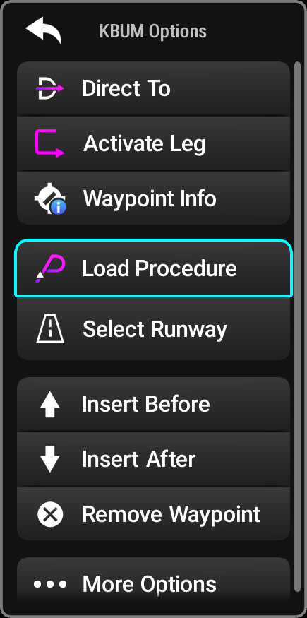

The system can access departures, arrivals, and approaches that are stored within the database. Procedures can be added to the active or stored flight plans.
205: Load Procedures Button on the 'Waypoint Options' Window

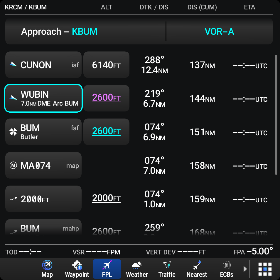

Whenever an approach, departure, or arrival procedure is loaded into the Active Flight Plan, a set of approach, departure, or arrival waypoints are inserted into the flight plan along with a header row identifying the procedure the pilot selected. The original enroute portion of the flight plan remains active when the procedure is loaded.
The system adds procedures to the flight plan based on the leg types coded within that procedure in the navigation database. Over twenty types of legs are possible in terminal area procedures, such as DME Arc to a Fix, course to a VOR radial, hold in lieu of a procedure turn, vector (heading) to an altitude. The system offers lines of text on each waypoint button to help identify each leg type in the selected procedure. The text provided will vary depending on the leg type and other attributes that are specified as part of the leg.
206: Attributes of Procedural Legs on Waypoint Button
