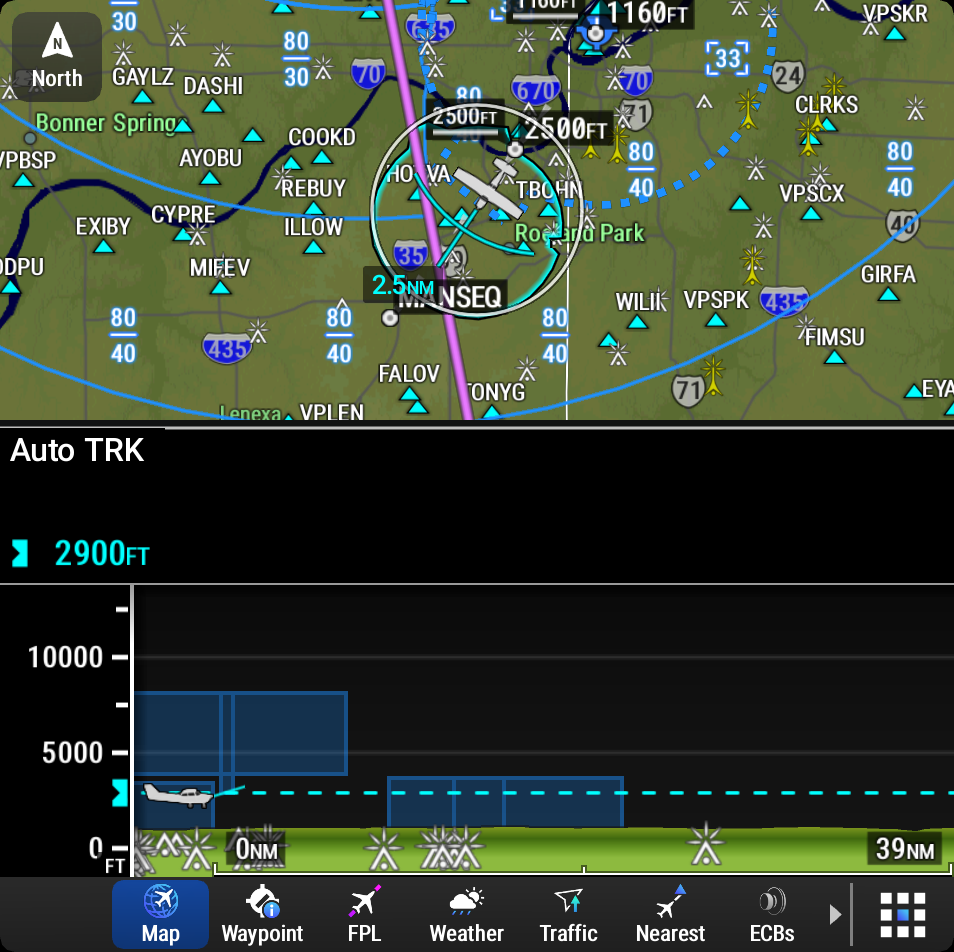

191: VSD Inset on MFW 'Map' Application Page
VSD range can be adjusted independently from the map display. Pan Mode is available while Flight Plan Mode (including Modified Flight Plan Mode) is selected.

The terrain depicted on the VSD is the highest point within the width of the swath determined by the phase of flight. In some instances when the width of the swath changes dramatically the terrain depiction on the VSD may display an abrupt vertical discrepancy. The scenario that this may be noticed the most is while flying an approach that is loaded into the flight plan where the swath jumps from a 0.6 NM swath to a 2.0 NM swath at the missed approach point.
192: Swath Width Terrain Discrepancy on the VSD
