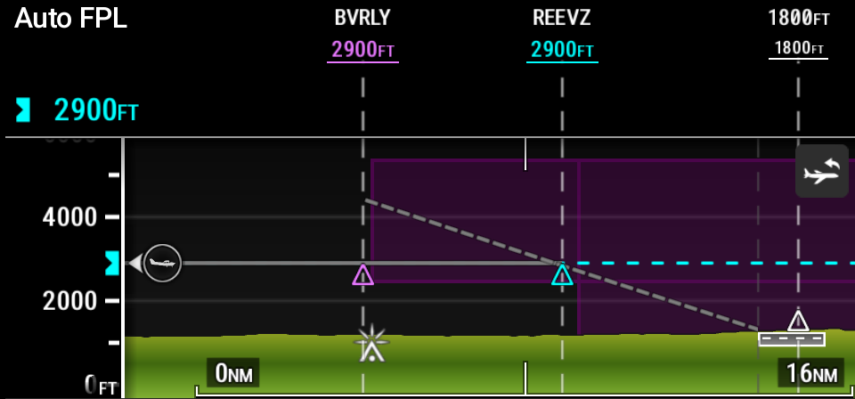

VSD Airspace Boundaries
Airspace boundaries as defined in the Navigation Database can be shown on the VSD. Airspace symbols on the VSD reflect what is shown on other map displays in a vertical form. If the aircraft is within an airspace boundary, the airspace is displayed in semi-transparent shading. The VSD defaults to drawing airspaces as defined in 'Map Settings', with the additional ability for the pilot to enable/disable airspace viewing specifically on the VSD.
193: Airspaces on the VSD
