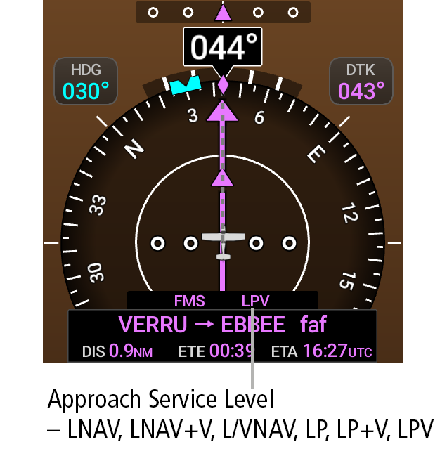

When the list of approaches displays "+V", this indicates the system will provide advisory vertical guidance when using GPS to fly the approach.
210: Procedures List of Available Approaches
Table 26: Approach Service Levels
HSI
Annunciation
Description
Example on HSI
LNAV
Approach to the published MDA
LP
LNAV+V
Approach with advisory vertical guidance to the published MDA
LP+V
L/VNAV
Approach with approved vertical guidance to the published DA
LPV
NOTICE
The system requires 30 seconds of valid SBAS integrity monitoring before selecting an approach that requires SBAS vertical guidance.
NOTICE
To ensure the system does not abort the GPS approach, both GPS receivers should have a VFOM less than 106 feet before loading a GPS approach.

Table 27: Source of Lateral and Vertical Navigation per Approach Service Level
Lateral Navigation Source
Vertical Navigation Source
LNAV
GPS
N/A
LNAV+V
GPS
GPS (advisory only)
LNAV/VNAV
GPS1
GPS1
LP
GPS1
N/A
LP+V
GPS1
GPS1 (advisory only)
LPV
GPS1
GPS1
1 SBAS required
