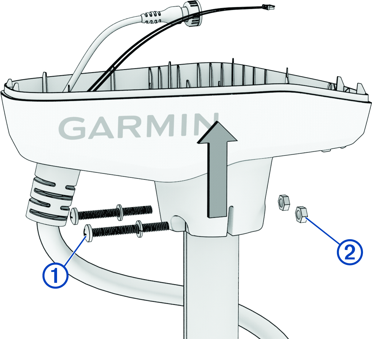

  2. Using a #3 Phillips screwdriver, remove the 1/4–20 bolts 1, lock washers, and nuts 2 that secure the shaft cap to the shaft.
    Shaft cap removal with callouts
    You should keep these bolts and nuts in a safe place, because you must use them when reinstalling the shaft cap.
  3. Lift up the shaft cap to disconnect it from the shaft.
  4. Pull the cables completely through the shaft cap, taking care to avoid damaging the cable connectors when you pull them through.
