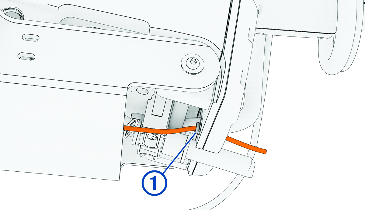

  1. Feed the smaller end of the new pull cable into the access hole on the mount base and up through the steering system.
  2. Using your hand through the underside of the motor, guide the small end of the pull cable under the pivot pin and out through the hole on the top of the steering system 1.
    Routing pull cable
  3. Pull the cable through until the larger end passes through the access hole.
  4. Place the larger end of the cable over the stud in the access hole.
  5. If necessary, rotate the cable to align the hole on the end of the cable with the hole on the stud, and push the R-pin through.
    Removing R-pin
    TIP: You can use needle-nose pliers to push the R-pin, if necessary.
