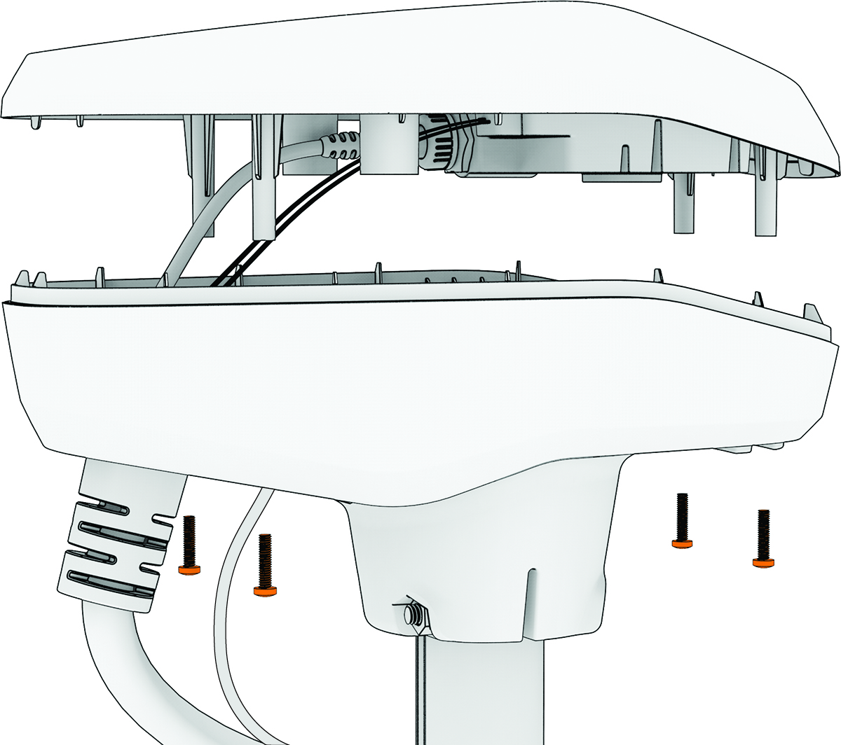

  1. Using a #2 Phillips screwdriver, remove the four screws that secure the lid of the shaft cap.
    Exploded view of the top of the shaft cap and the screws that secure it to the shaft cap
  2. Carefully lift up the lid of the shaft cap to access the cable connectors inside.
    NOTICE
    There are two cables connected to the top of the shaft cap. Take care when opening the shaft cap to avoid damaging the cables or connectors.
