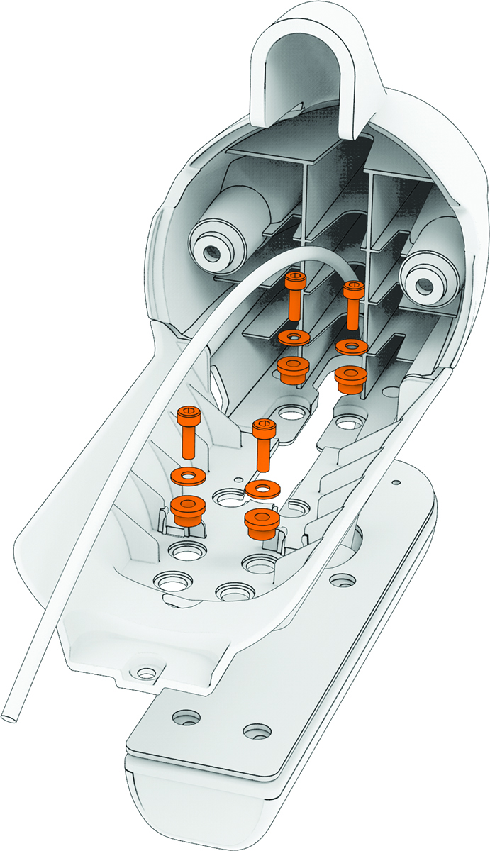

Removing the Transducer from the Nose Cone
Before you can remove the transducer from the nose cone, you must remove the skeg and nose cone from the propeller drive motor (Removing the Skeg and Nose Cone).
Using a 3 mm hex bit or driver, remove the screws that secure the transducer to the nose cone parts.
