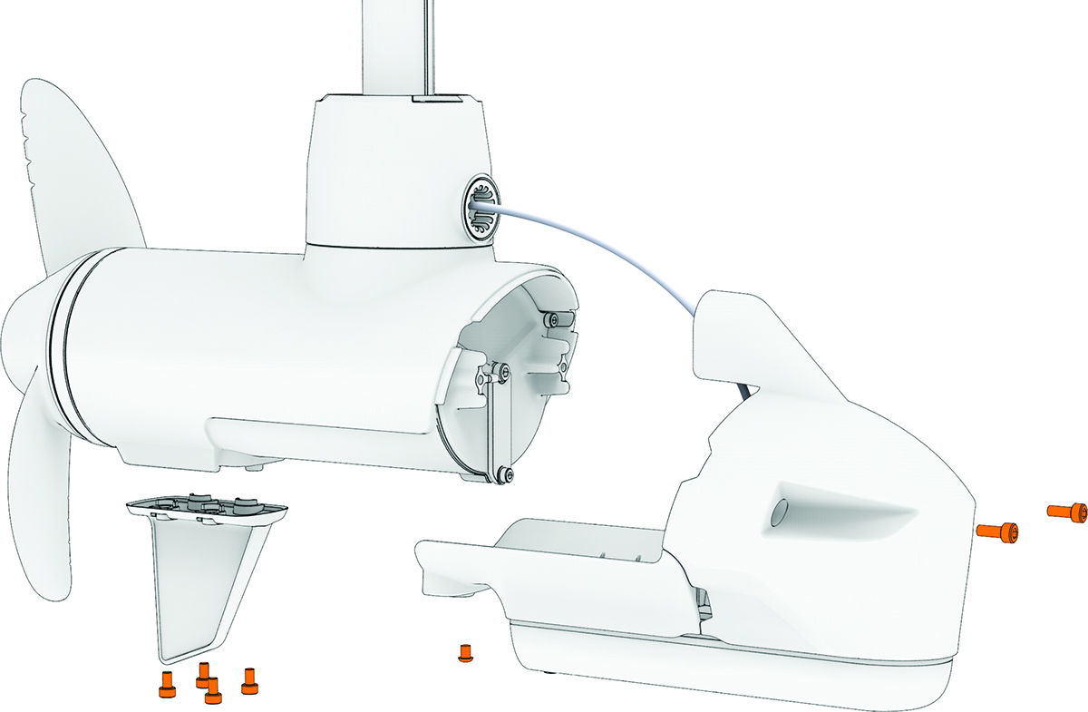

Removing the Skeg and Nose Cone
  1. Using a 4 mm hex bit or wrench, remove the four screws that secure the skeg to the propeller drive motor.
    Exploded view of the skeg and nose cone with callouts
  2. Remove the skeg.
  3. Using a 4 mm hex bit or wrench, remove the two screws that secure the front of the nose cone to the propeller drive motor.
  4. Using a 3 mm hex bit or wrench, remove the single screw that secures the bottom of the nose cone to the propeller drive motor.
    NOTE: You should keep all of these screws and parts in a safe place, because you will reuse them when reassembling the skeg and nose cone.
