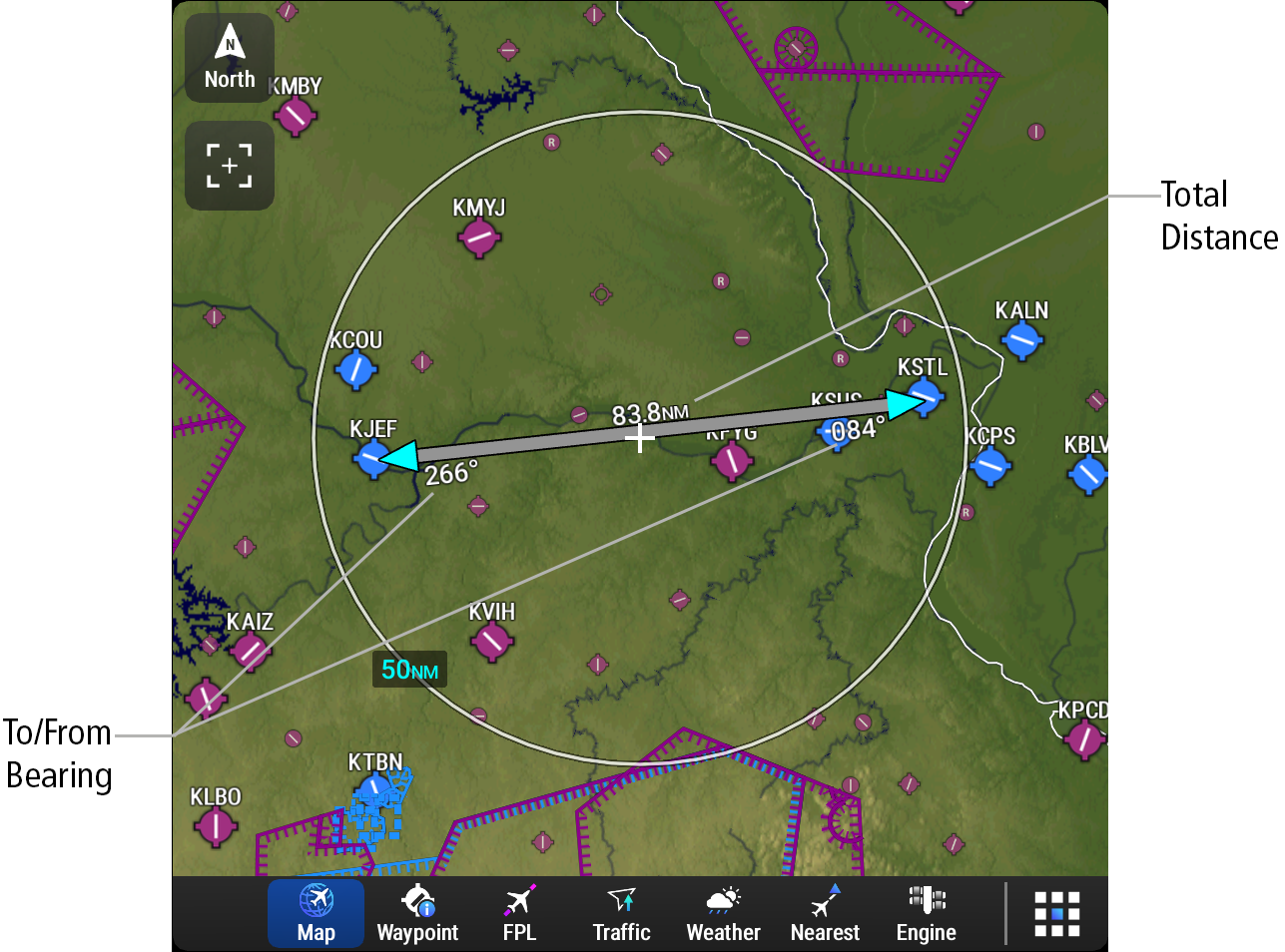

A Measurement Line can also be created between any two points on the map. The bearing and distance tool displays a white Measurement Line and a cyan Measure Pointer to aid in graphically identifying the points to measure. Distance measured is displayed above the Measurement Line; bearing is displayed below, and adjacent to, the Measure Point.
149: Measuring Bearing/Distance between Two Points
If the range is adjusted and/or Pan Mode is activated while measuring bearing and distance the following will occur:
  • The end points of the measurement shall remain located at the lat/lon at which they were before adjusting the range or activating Pan Mode.
  • The Measurement Line and Measure Pointer(s) shall be removed from map if the range is adjusted too far or under its display location.
