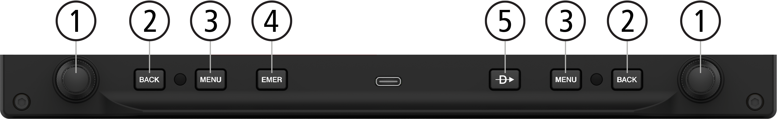

Bezel Controls
1
DCK
The dual concentric knobs are used to navigate the AXIS™ system. The DCK can also be pushed for selection of different data fields.
2
BACK Softkey
Press to return to the previous screen.
(MFW side) Press and hold to return to the base-level of the active application. If already at the base-level of any application, pressing and holding will toggle the display between split and full screen.
(PFW side) Press and hold to toggle between full-screen and split-screen modes.
3
MENU Softkey
Press once to view the active windows application menu.
Press a second time to open the 'Apps' Window.
4
EMER Softkey
Press once to display the emergency window.
Long press to activate Smart Glide™ if enabled
5
Direct-To Softkey
Press to activate the Direct-To function, enter a destination waypoint and establish a direct-to course to the selected destination.
Long press to activate Smart Glide if enabled
