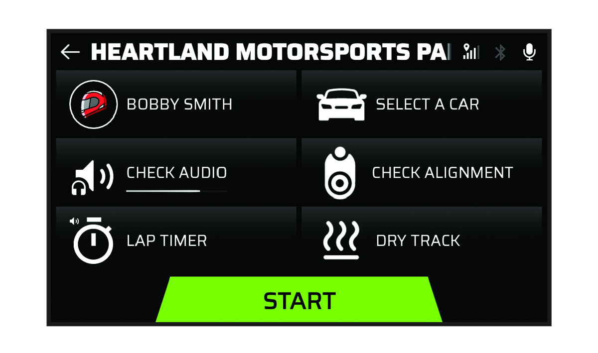

    Screenshot of the race start screen
  3. Select an option:
    • To change your driver profile, select Driver profile.
    • To change your vehicle profile, select Vehicle.
    • To configure audio features, select .
    • To change your track conditions, select Dry track or Wet track.
    • To configure lap timer settings, select .
    • To enable or disable audio recording, select Microphone.
  4. Select Check Alignment and follow the on-screen instructions to adjust your camera alignment.
  5. Select Start.
  6. Start driving.
    The timer starts automatically when you cross the start line.
