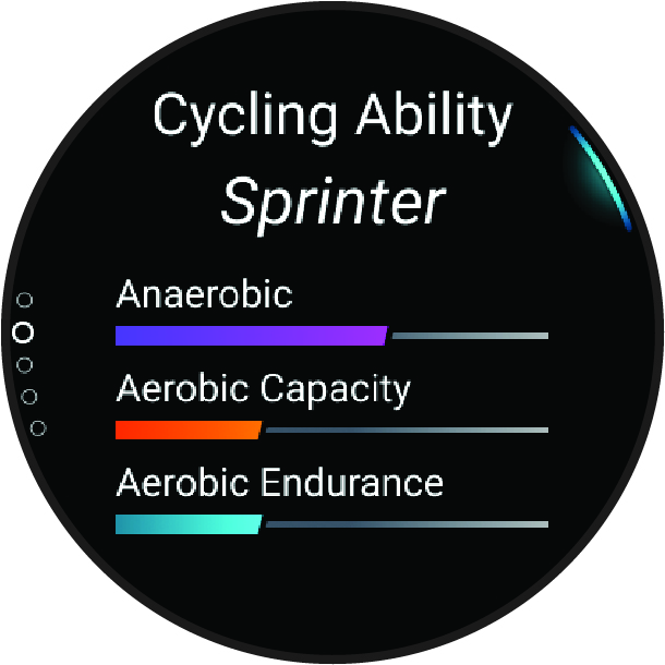

  2. Press Upper-right button to view your current rider type.
    Cycling ability glance with data
  3. Press Upper-right button to view a detailed analysis of your cycling ability (optional).
