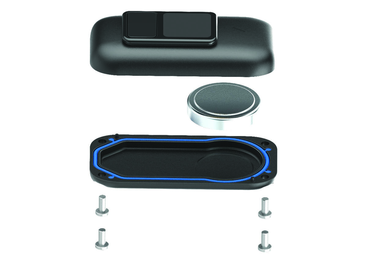

  3. Remove the rear case and battery.
    Exploded view of the device
