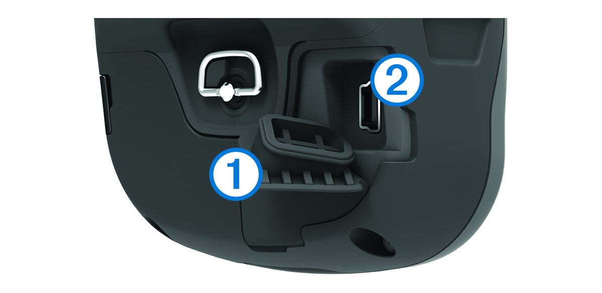

Charging the Battery Pack
To prevent corrosion, thoroughly dry the mini-USB port, the weather cap, and the surrounding area before charging or connecting to a computer.
Do not attempt to use the device to charge a battery that was not provided by Garmin®. Attempting to charge a battery that was not provided by Garmin can damage the device and void the warranty.
Before you can connect the straight connector of the USB cable to your device, you may need to remove optional mount accessories.
NOTE:
The battery does not charge when outside the temperature range of 32° to 113°F (0° to 45°C).
You can charge the battery using a standard wall outlet or a USB port on your computer.
