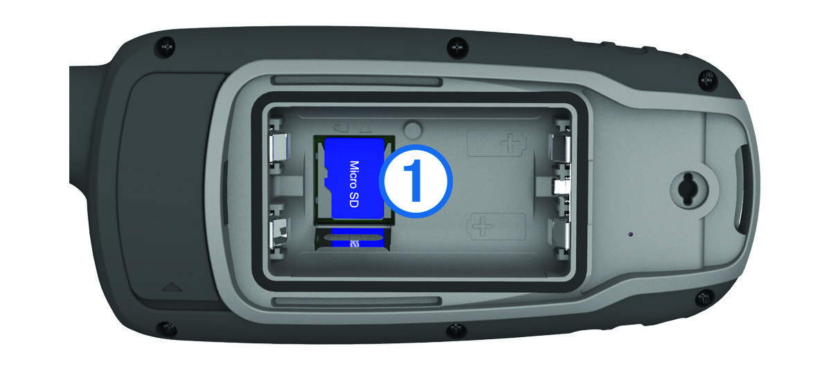

You can install a microSD® memory card, up to 32 GB, in the handheld device for additional storage or pre-loaded maps.
  1. Turn the D-ring counter-clockwise, and pull up to remove the cover.
  2. Remove the batteries.
  3. Slide the card holder Callout number one to Unlocked symbol and lift up.
  4. Place the memory card with the gold contacts facing down.
    Memory card slot with a callout
  5. Close the card holder.
  6. Slide the card holder to Locked symbol to lock it.
  7. Replace the batteries and cover.
