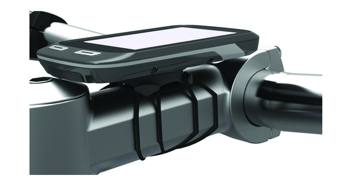

    Device mount with callouts
  3. Place the bike mount on the bike stem.
  4. Attach the bike mount securely using the two bands Callout number two.
  5. Align the tabs on the back of the device with the bike mount notches Callout number three.
  6. Press down slightly and turn the device clockwise until it locks into place.
    Device mounted on the bike
